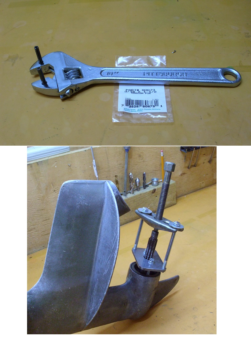

                #55448
                  105 or J.D. Corn Head Grease.
                  These are the tools I
                  made to work on them.
                  #55466
                  nali
                    This wrench with 2 rods is a really nice idea !
                    Not only for a Mercury, but I’m sure it can be useful for some other projects.
