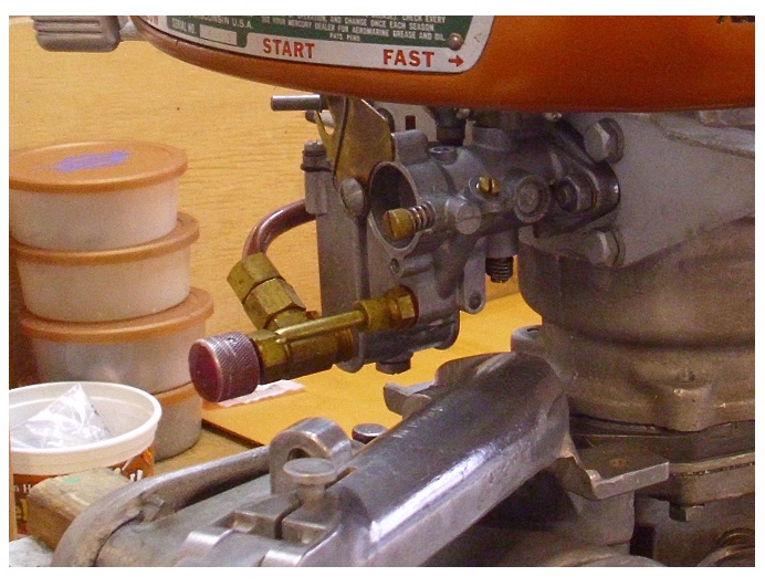

      In a general manual I bought I found the initial
      settings are
      Low speed – 1 turn out
      High speed 1-1/2 turn out
      Doesn’t say which is which.
      I’m guessing the long one is fuel for the main jet
      and the short one is air for the idle/slow speed circuit.
      As I don’t know and there are people here that do
      it only makes sense to ask.
      #47035
      dave-bernard
        yes the bottom one is high speed and the top is low speed.
        #47065
          Thanks
