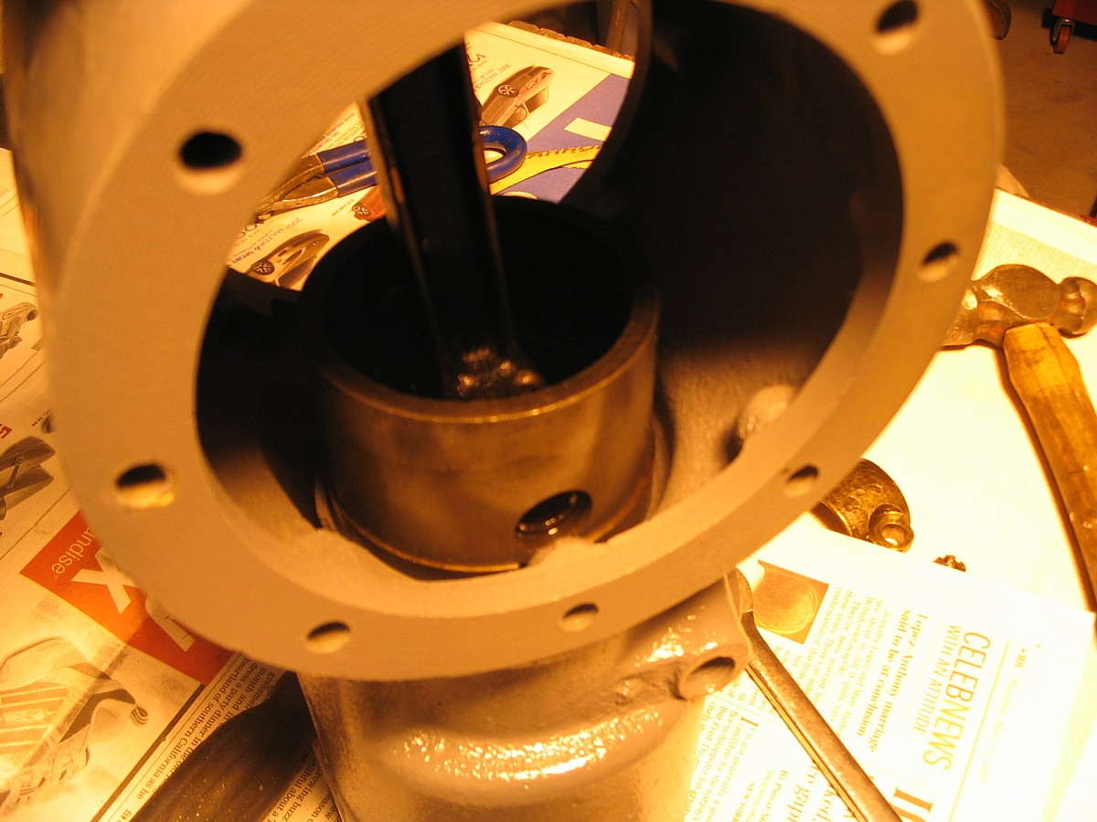

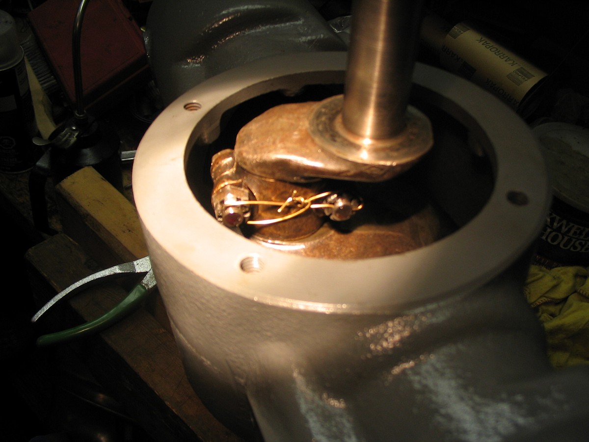

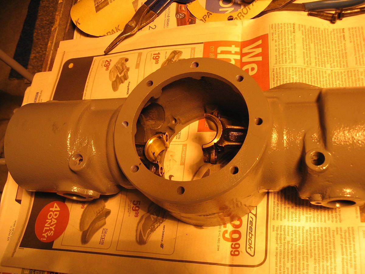

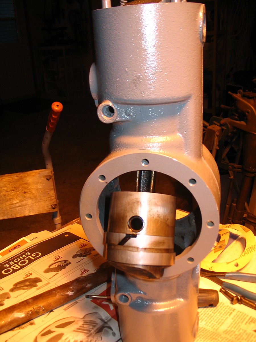

        WHen putting the powerhead together – pistons go in through the centre hole, rod end first, then slide it partway into the bore opposite of the one you want to actually insert the piston into.
        The chamfers at the bottom of the cylinders are quite generous, and help greatly with compressing the rings.
        With both pistons in and up near TDC, you can fit the crank in there and button up the rods.
        I used safety wire, practiced with brass first, then used Mechanic’s Wire for real.
        Sorry for the weird lighting, I was experimenting with a 400 watt High-Pressure Sodium lamp over my work bench.
        Hope this helps.
        Best, PM T2
