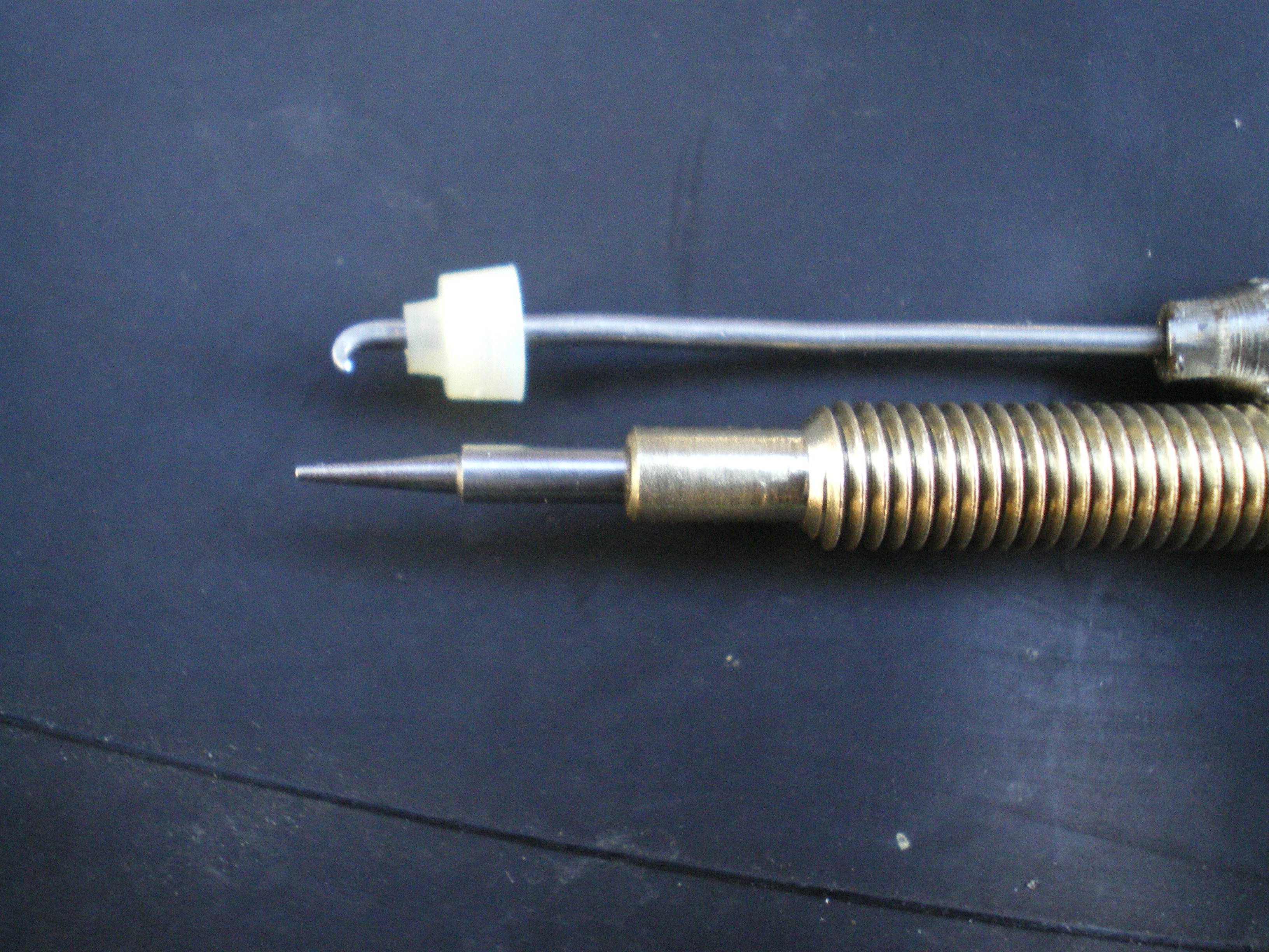

        I like those all metal 70’s-80’s 9.9/15 carbs except for the little plastic needle bearing . Carefully digging that out of the low speed needle passage is a task.You got to be gentle so as to not gouge up the needle recess down in there.

          Pulling the small plastic bearing is easy peasy if you use a small hook. I use a dental pick with a small hook on the end but a paper clip might work to.
          #78280
          PugetSoundBoater
            That’s a good little tool you made there Mumbles. I will remember that for next time as i’m sure there will be one. 😀
