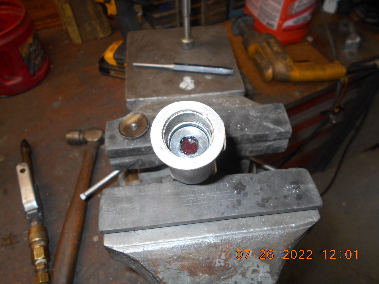

      Frank, interesting, I don’t remember running across that style of breather,
      but then again, there’s lot of things I don’t remember!
      I tore the breather off the parts Lauson this morning, and popped the
      “Hubbard” plug out. As the one you show, I’m guessing this one
      is of similar design, as it appears to be a fiber disc that’s caged.
      However, this one allows flow in only one direction that I could tell
      by blowing through it.
      I may have damaged the other one by blowing compressed air through it.
      Glad I got talked into opening up the spare breather, as it’s now going
      on the project. Photo tonight perhaps.

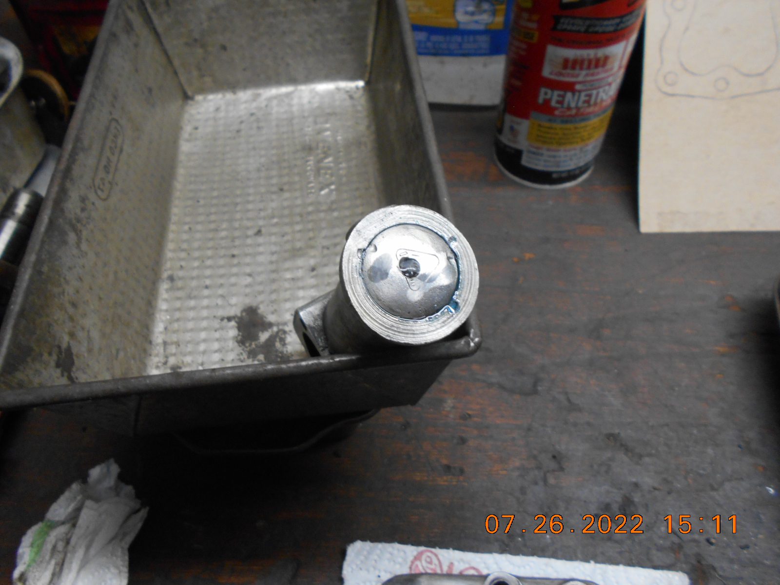

            Photo of the subject breather.
            A caged fiber disc, and this one actually works like a check valve,
            so I’ll have to paint it up now. I only found smaller and larger core
            plugs in my stash, so I JB Welded the hole that I drilled in the plug to
            pry it out, tapped it back in place, and used a little thread locker.
            Grandpa would be proud I didn’t buy a new core plug!
            DSCN4211
            DSCN4217
