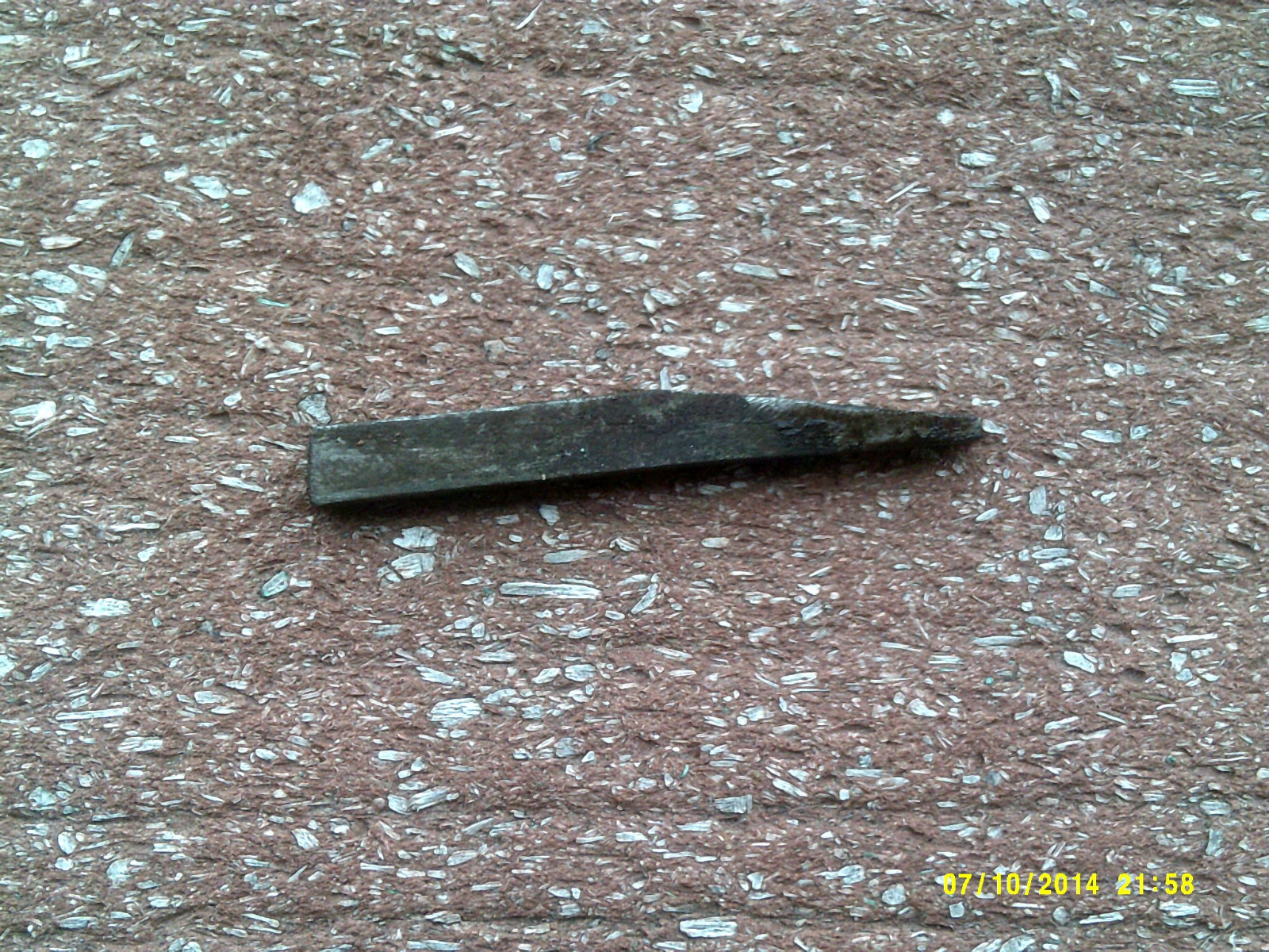

                Well, I got it to fire for a millisecond and promptly sheared the flywheel key. I had noted that the key was showing signs of fatigue, and despite what I thought was adequate torquing, it let go on me.
                picture upload
                I see there is one on Ebay that looks similarly worn. Also it is from the S300 motor, so I am uncertain if it is the correct dimensions.
                What type of stock can I use to fabricate a replacement ?
                #23423
                  Nothing fancy. Just steel key stock.

                  #23427
                  wedgie
                    Thanks again Frank.
                    Too bad Mcmaster doesn’t deal with Canada. I will check around locally.
                    #23430
                    brian
                      After you replace the flywheel key I believe there is a magneto adjustment to set the timing but it’s been years since I worked on one. I will check and see if I have a T600 manual which is the same basic engine design.
