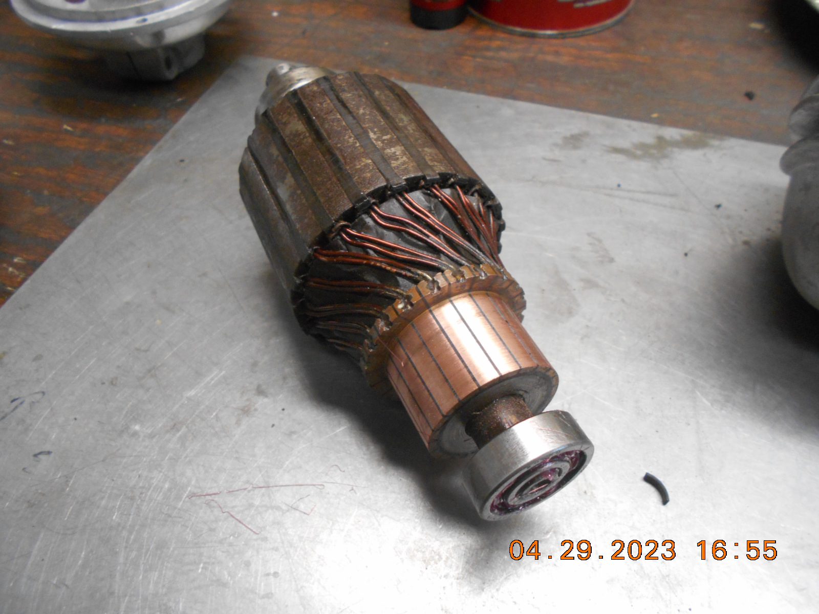

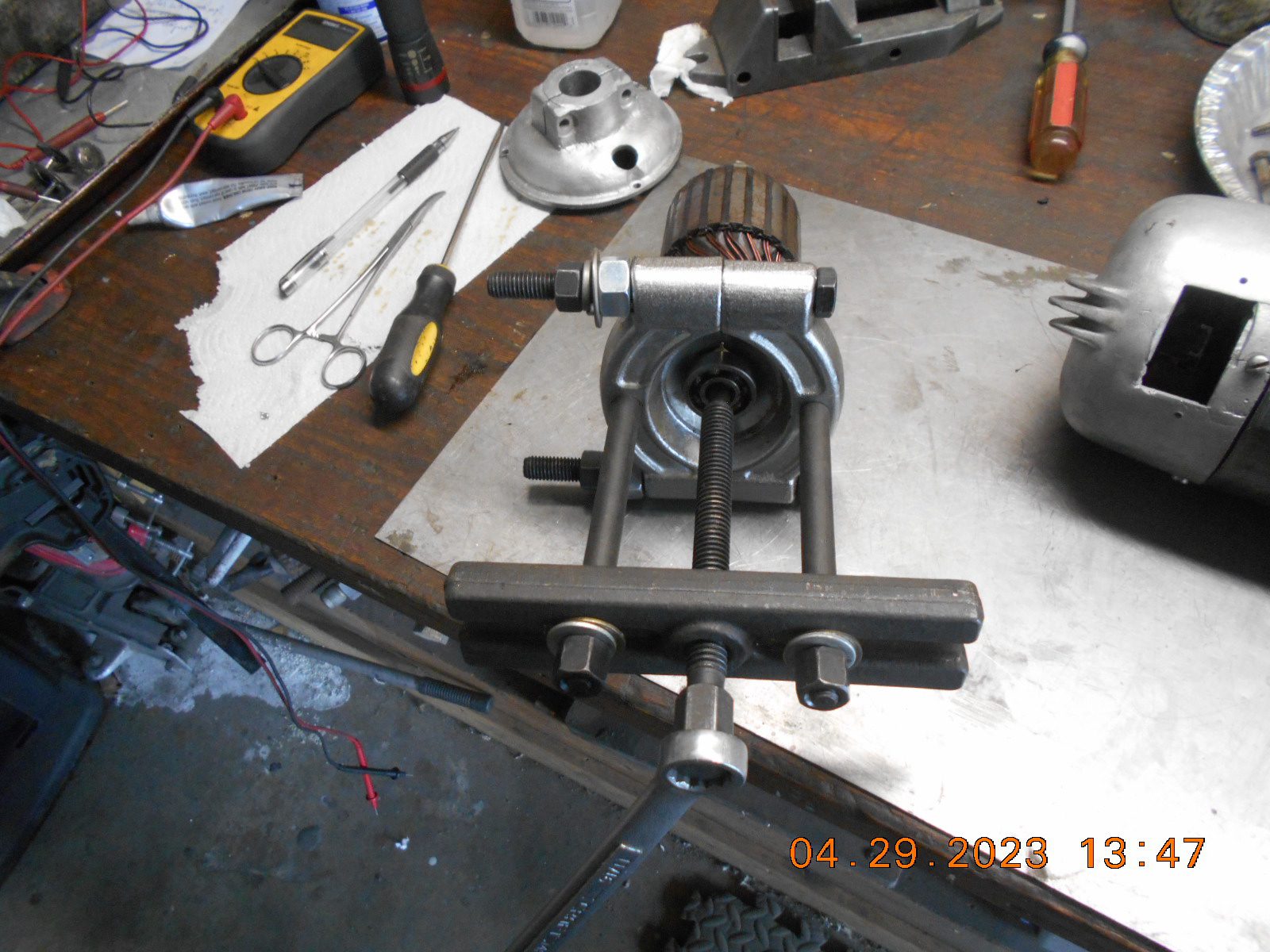

      Today I pulled both ball bearings off the armature so I could clean
      the old dirty grease out, and then repack the bearings.
      I shined up the commutator, spinning the armature on the lathe,
      and used sand paper.

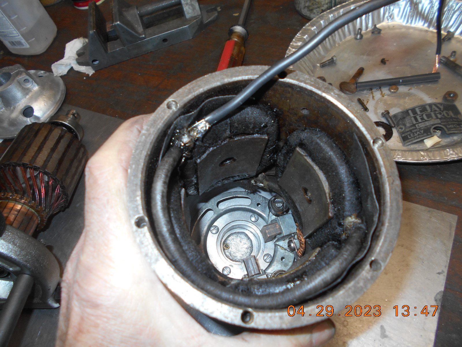

      I “tried” soldering on a heavy gauge wire to a field coil connection that
      looked like it had a wire hooked to in the past.
      I put the motor back together, omitting the rheostat, seeing if I could
      get any action out of the motor using a 12v battery.
      While my solder job adding the hot wire to the field coil looked “fair”,
      the connection failed right away and the motor never got excited!
      Back to the drawing board.
      DSCN6850
      DSCN6851
      DSCN6849

        I did make a little progress today. After my soldering job failed yesterday,
        I retried attaching the hot lead to the field coils.
        Again, I tinned the lead wire, but this time, bound it to the field coil wire terminal,
        using four strands of copper wire, then soldering over it all.
        Time will tell.
        I finally came to the conclusion that the Rheostat didn’t have to going
        in the “hot” side of the circuit, so I wired it into the ground. I’m pretty
        sure that’s correct for this unit……… at least it appeared
        to work on the bench.
        Sadly, the 12v battery sat in the tractor all winter, was down to 9 volts,
        and out of “oomph”!
        Will try to charge the battery tomorrow and play around some more.
        I had to order some grommets for the wires going through the motor
        case, so the wires aren’t permanently routed yet.

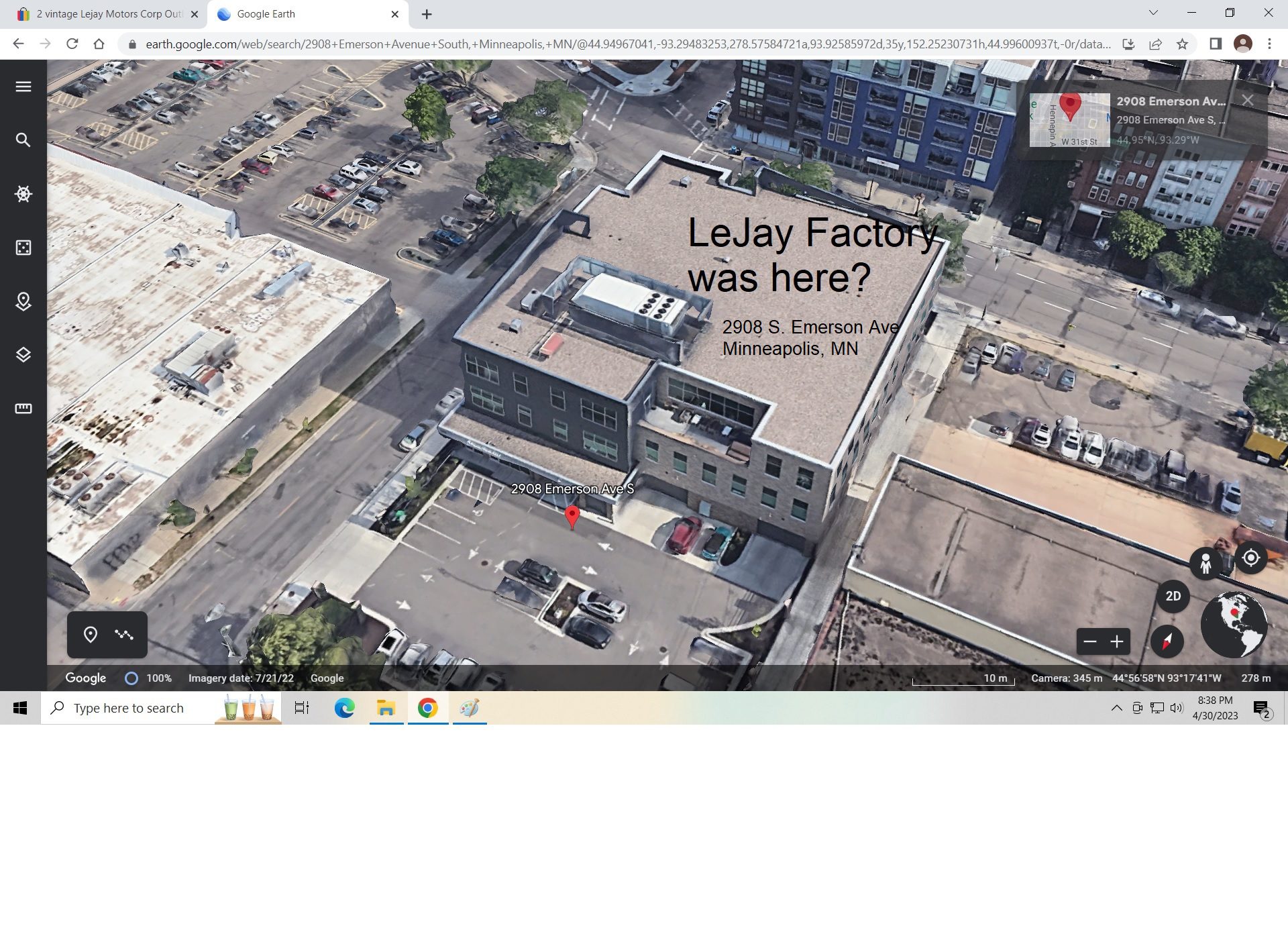

          Using that phamplet’s address, this is the location Google Earth
          came up with. Sadly, looks like LeJay is “Out of Business”, or
          built a newer building!
          LeJay-Electrol-factor-location

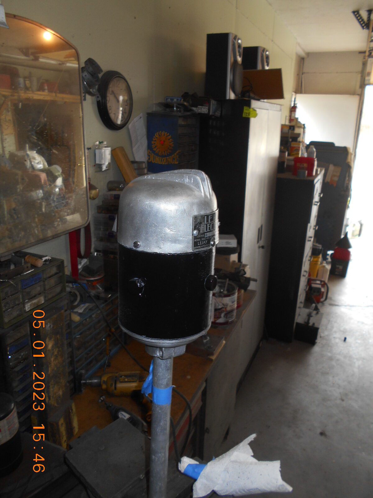

            I tried the LeJay again today, with a fully charged battery.
            Spins over great now, but the rheostat doesn’t seem to
            regulate the rpms very good, but hey, it’s probably 80
            years old.

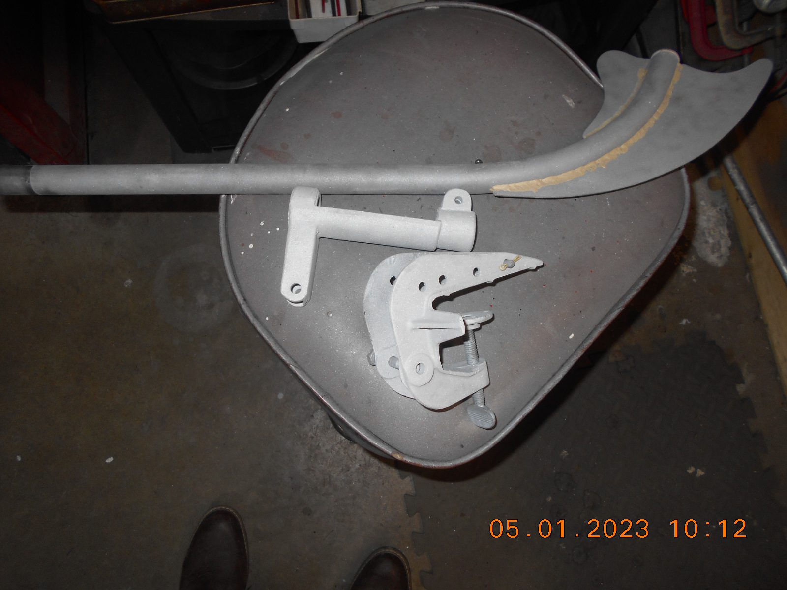

            I tapped a wood dowel into the motor where the driveshaft would
            hook up, just to see some action.
            A “one” inch piece of electrical conduit fits in the motor base perfect
            as a “holder” to paint the motor.
            Once I get the new grommets, I’ll have to pull the bottom of the motor
            back off and route the wires properly.
            Got the rest of the parts cleaned and painted up today.
            I tapped a wood dowel in the bottom of the motor where the driveshaft
            hooks up, just to see some “action”.
            Maybe it will debut on the boat this summer, then go back on the rack
            for a few years!

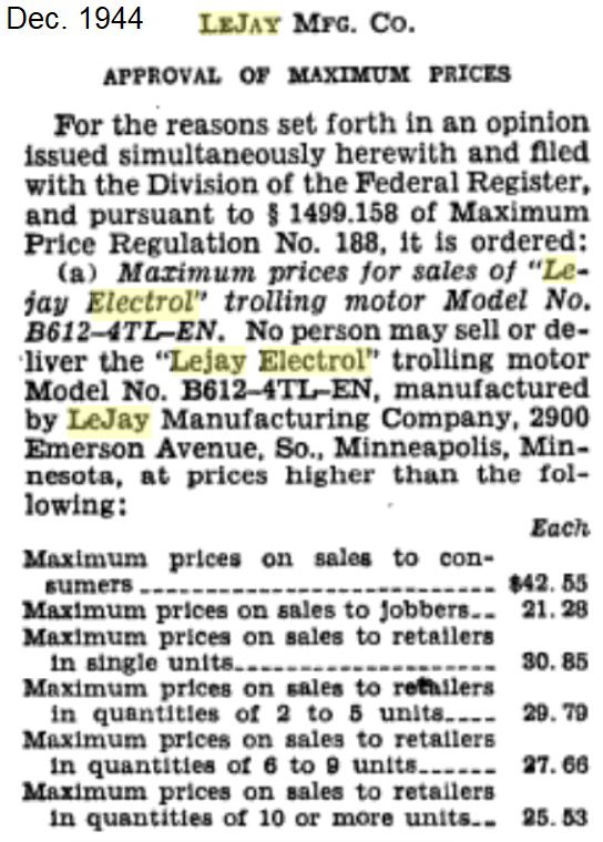

              #275862
                Joe, funny you should ask about the price. I stumbled upon
                that a couple of days ago –
                $42.55 retail, in 1944, for the same model mine is.
                LeJay-B612-4TL-EN-Price
                #275871
                JOSEPH BRINCAT
                  $42.55 was pretty pricy for 1944, that’s about what a small 2 cycle outboard would cost.
                  Joe B
                  #275881
                    Pricey, and more hassle to take those one or two batteries
                    in and out of the boat, than that little gas outboard.
                    Joe B
