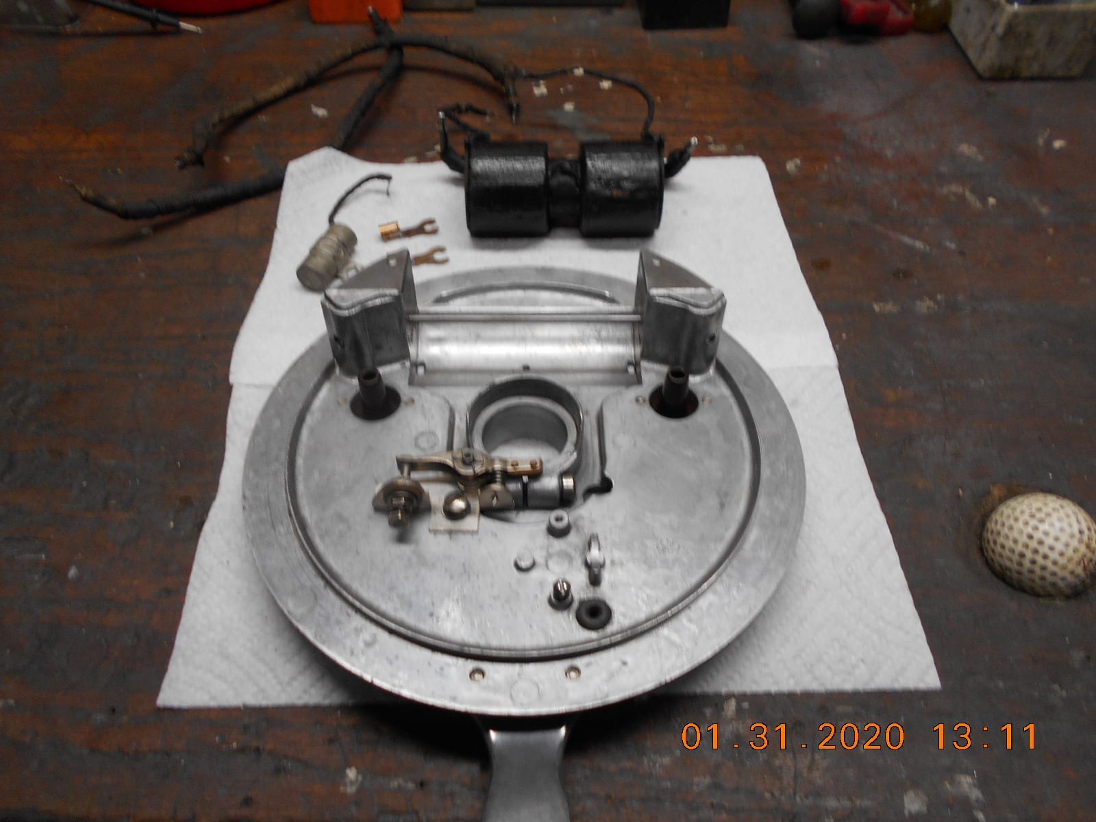

      Mag plate is now cleaned up, and I’m awaiting advise on what
      Military Surplus coil to try to obtain, and perhaps where.
      I have a couple of ZongKong coils I could try, but decided
      against using them on the last project, as the green Sierra coils
      were apparently “better”.
      For kicks, I re-tested the Eisemann coil from the Lockwood today.
      Primary with the ohm meter .4 to .7, secondary, when I could get
      a reading at all, it averaged around 13 k ohms.
      I could get no reading on the secondary using my old analog ohm meter.
      I threw it on the Stevens tester, and I did get if to fire at around 2 amps.
      I’m guessing that the secondary is buggered?
      DSCN8679
