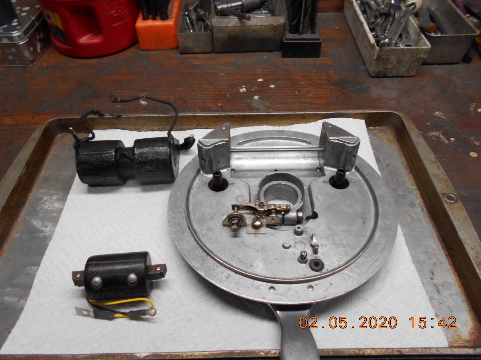

        T….in Wisconsin
          Hello Stanley, Buccaneer & Tubbs
          Do you know if these coils are still available? As expected the link noted has expired.
          Recently picked up a 72T that’s in good condition but  will need a coil replacement, wires, & condenser, Wires & condenser  I already have.
          I’ve found some info on the coil replacement, unsure as to how they mate with the heels.
          Had to step away from motor work for a while to attend to family matters, it’s good to have more time again.
          Thanks

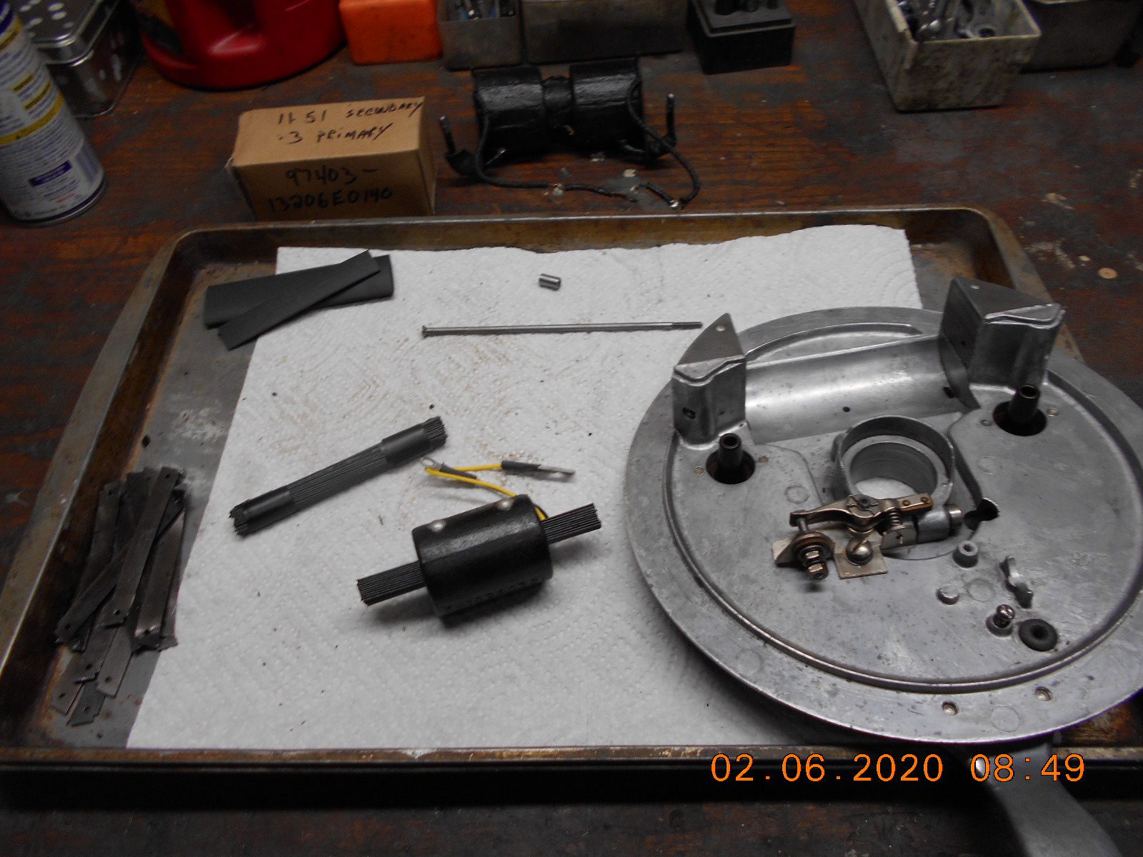

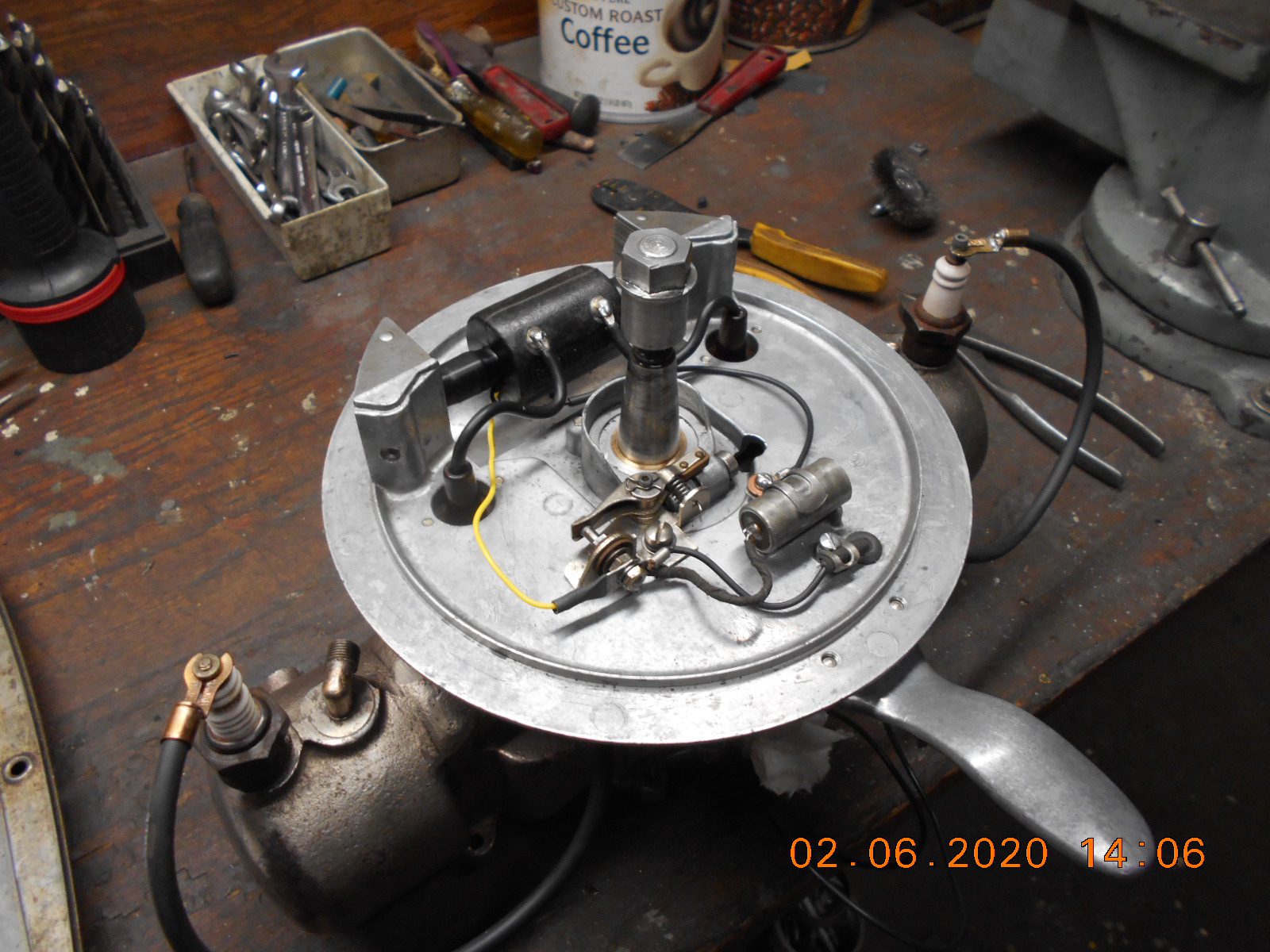

          #284749
            I can’t remember much about how the coil laminates attached
            to the heels, but my photo seems to suggest there’s a “through”
            bolt through the heels and coil laminate, and that the coil’s
            laminated simply “butt” up against the heels??
            DSCN8709
            DSCN8710
            DSCN8714

            T….in Wisconsin
              That’s certainly what it looks like, could it really be that easy!
              You did a really nice job on this.
              #284755
              T….in Wisconsin
                Pleased with how the mag plate looks.
                Lockwood Engineers put some thought into easily removing the flywheel, nothing like the South Bend “A”.
                #284757
                  This is what I had previously posted.
                  I used the OMC style coils instead.
                  I have the starting instructions and
                  will post them when I find them.
                  Too much advance and your shoulder
                  will be sore for a week if your young,
                  and a month if your my age.
                  #284767
                  T….in Wisconsin
                    Nice jobs, great information as always.
                    Was the original rod damaged or ? Oh, I now see your’s was missing.
                    Rod on mine has a straight screw slot. Nut end is also slotted but restricted by the rod protruding past the end.
                    It appears the pins just butt up against the heels.
                    You prefer the OMC coils vrs the military coil, any particular reason or just preference….learning here!
                    #284768
                    T….in Wisconsin
                      72T coil, very similar to 62T coil I’d think.
                      You make it look easy, but I”m sure it’s not as easy as it looks, time & patience.
                      Thanks again.
                      #284772
                        I don’t have a coil preference. I used what I had.
                        I believe this is the mag you have .
                        There may be something here you can use
                        no matter which coil you choose.
