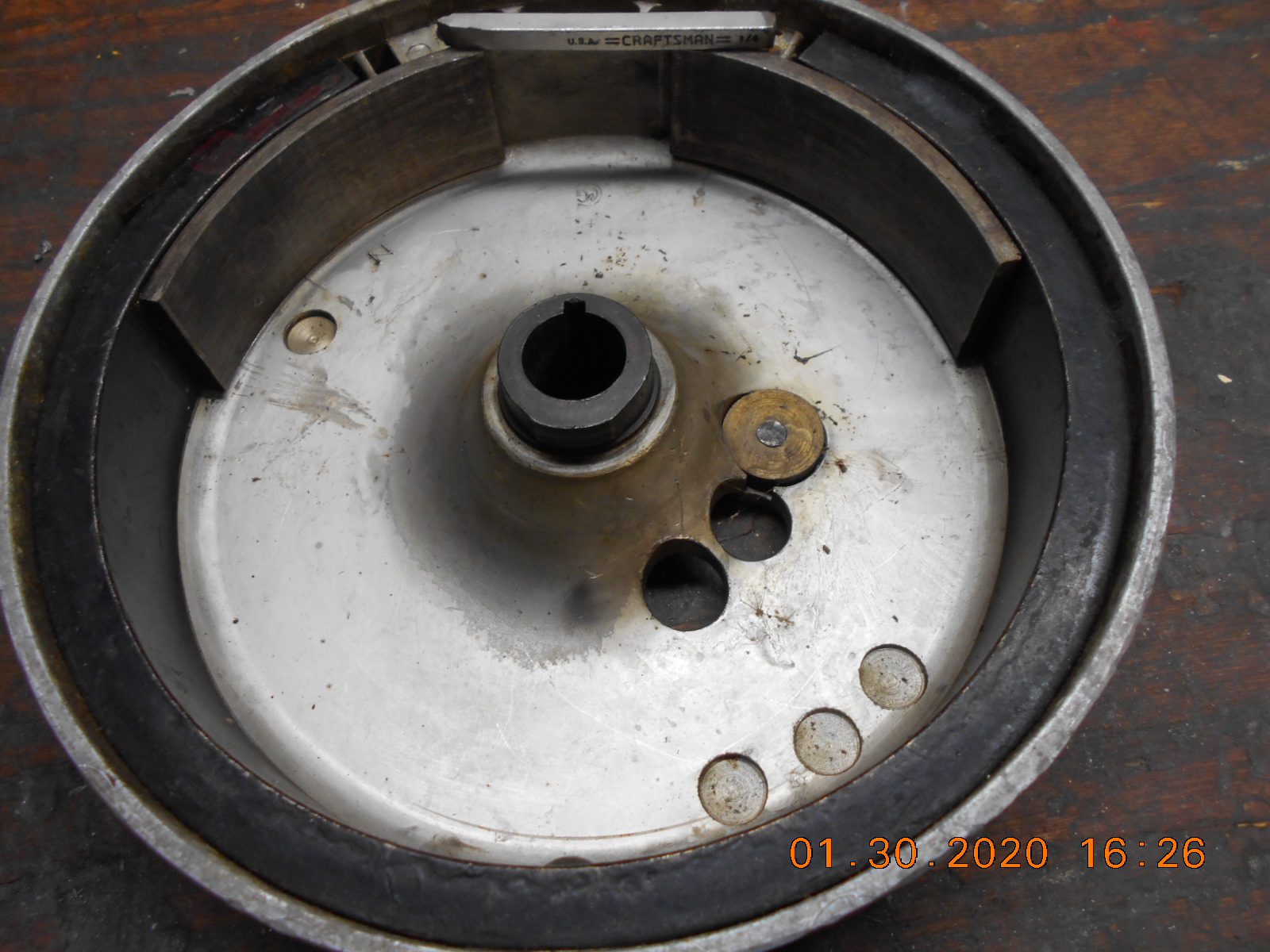

Point checking and adjustment:
I’m not finding any type of mark on the mag plate and flywheel to set the orientation and check the gap as is done on other vintage motors.
Is there a trick or tip on how to check and set the point gap?
Gap, .020″ same as most?
T…

February 17, 2024 at 10:28 pm #285111Just observe the points through the two holes in the flywheel, and adjust through
the holes. You might need to make a feeler gauge out of shim stock to fit through
the flywheel hole better. You’ll have to go back and forth between the two holes
adjusting, and checking the gap. Observe the points opening during a few
revolutions afterward to make sure they’re only opening .020.Prepare to be boarded!
February 18, 2024 at 7:31 am #285113This makes total sense being there are no timing marks to work from. Shouldn’t be that difficult I have a set of smaller feeler gages that will work well for this application. Thanks for noting to set to a max gap of .020″.
T… in Wisconsin
February 19, 2024 at 3:42 pm #285150Update: Pleased to report I now have strong spark at both plugs!
