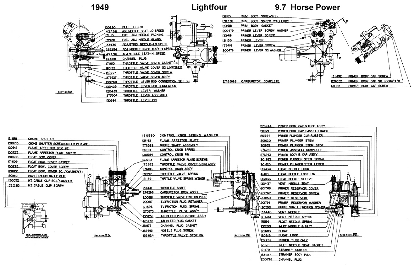

    Hey, have a running Zephyr but need to replace the needle for the needle and seat assembly. The end of shaft broke off where pin inserts to hold spring, applying pressure up against seat. Anybody with experience with this issue and is there a way to fix the needle shaft??

        Lightfours and Zephyers use the same 275201 inlet needle and seat assembly. . . 😎
