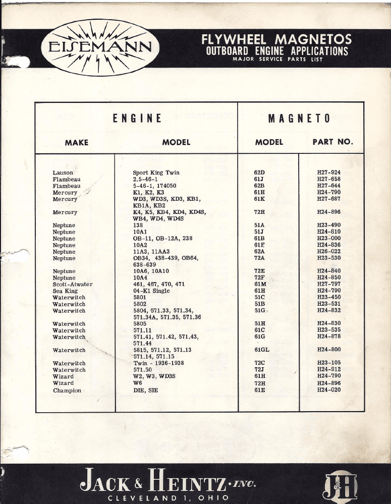

Here’s a couple Eisemann magneto outboard applications I had on file, if anyone is interested.

That looks to be the coil. This was posted
by MAS in 2014. I believe he was as successful.
Others have also attempted this but they
weren’t successful. You are not the first to be
looking for a solution to replace this coil as
it is often bad. If you do attempt this taking
pictures with explanations would be helpful
for others in the same position, if you succeed.
Good luck.
Tubs.
OK….so is it the same Pony Coil that will work on the WICO mag that OP hondaatc has that will also work on the Eisemann 62D Mag that I have on my T600?
Are both mags suffering from the same hard-to-find coil issue?
I guess my real question is which coil would be a work-a-round for the Eisemann 62D mag?
May 9, 2022 at 2:57 pm #259632The JD pony coil should work on the Eisemann 62D magneto with the modified laminations. I believe some others have also tried using a Briggs & Stratton twin cylinder lawnmower coil. As Tubs noted, some folks have had success with the pony coil or B&S conversion whereas some others have not.
You are correct that both the Wico and Eisemann coils are hard to find parts. There are a couple sources out there for the Eisemann coils used in the old Maytag motors but those typically used the 72D magneto and I don’t know if those would interchange with your 62D magneto. I do know the coils used on the 62D and 72D mags have different part numbers which might suggest a different configuration or they could just be different numbers solely due to the different magneto numbers.
