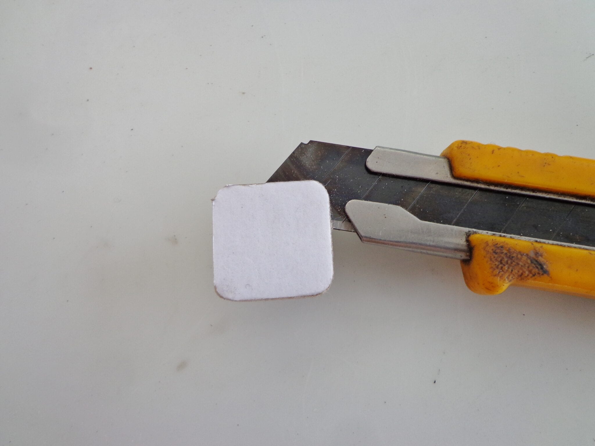

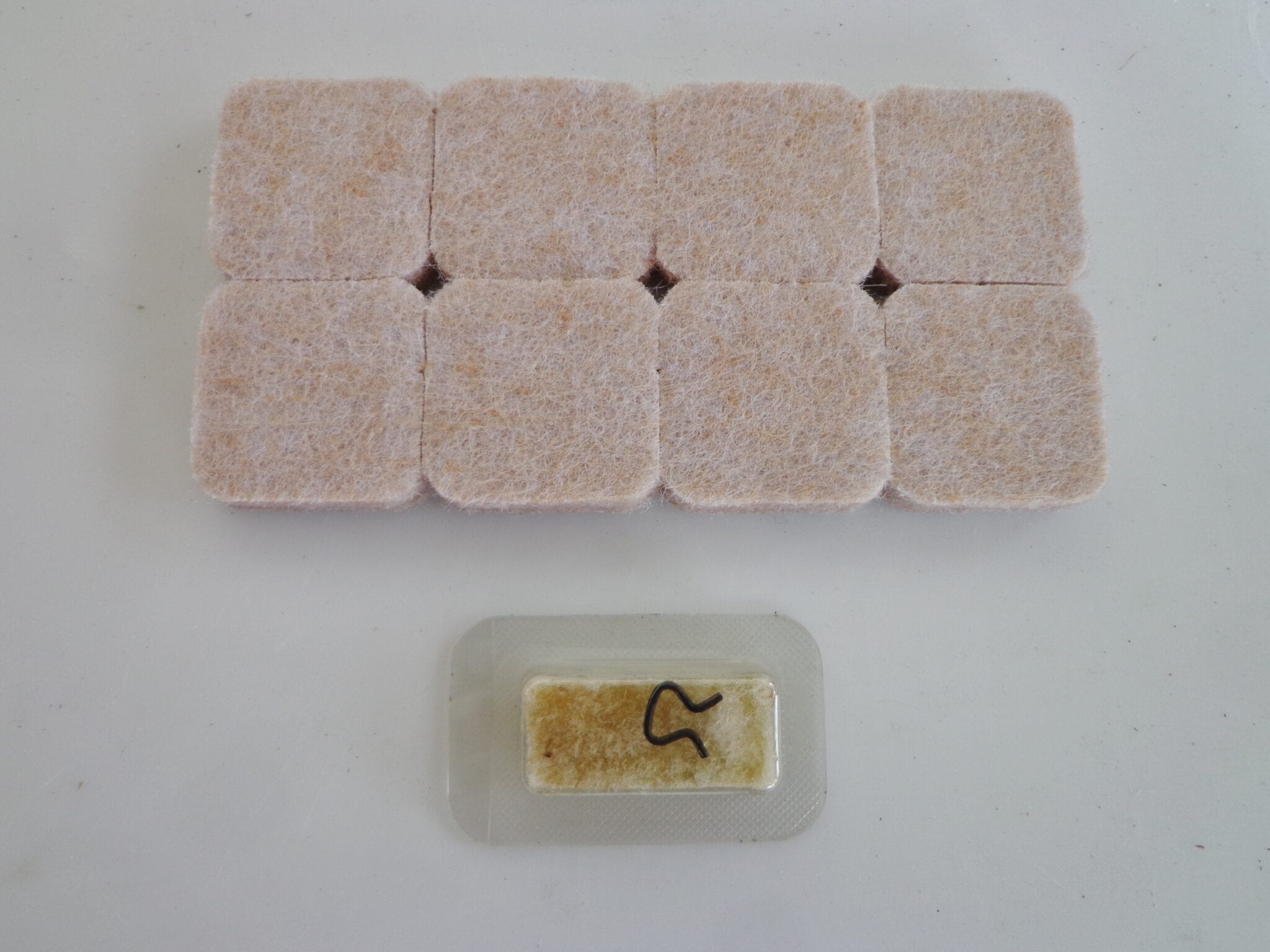

          You can get the felt pads in different sizes at Home Depot for a couple bucks and one pack should last a lifetime! After cutting to size and trimming the hard adhesive off, they work fine.

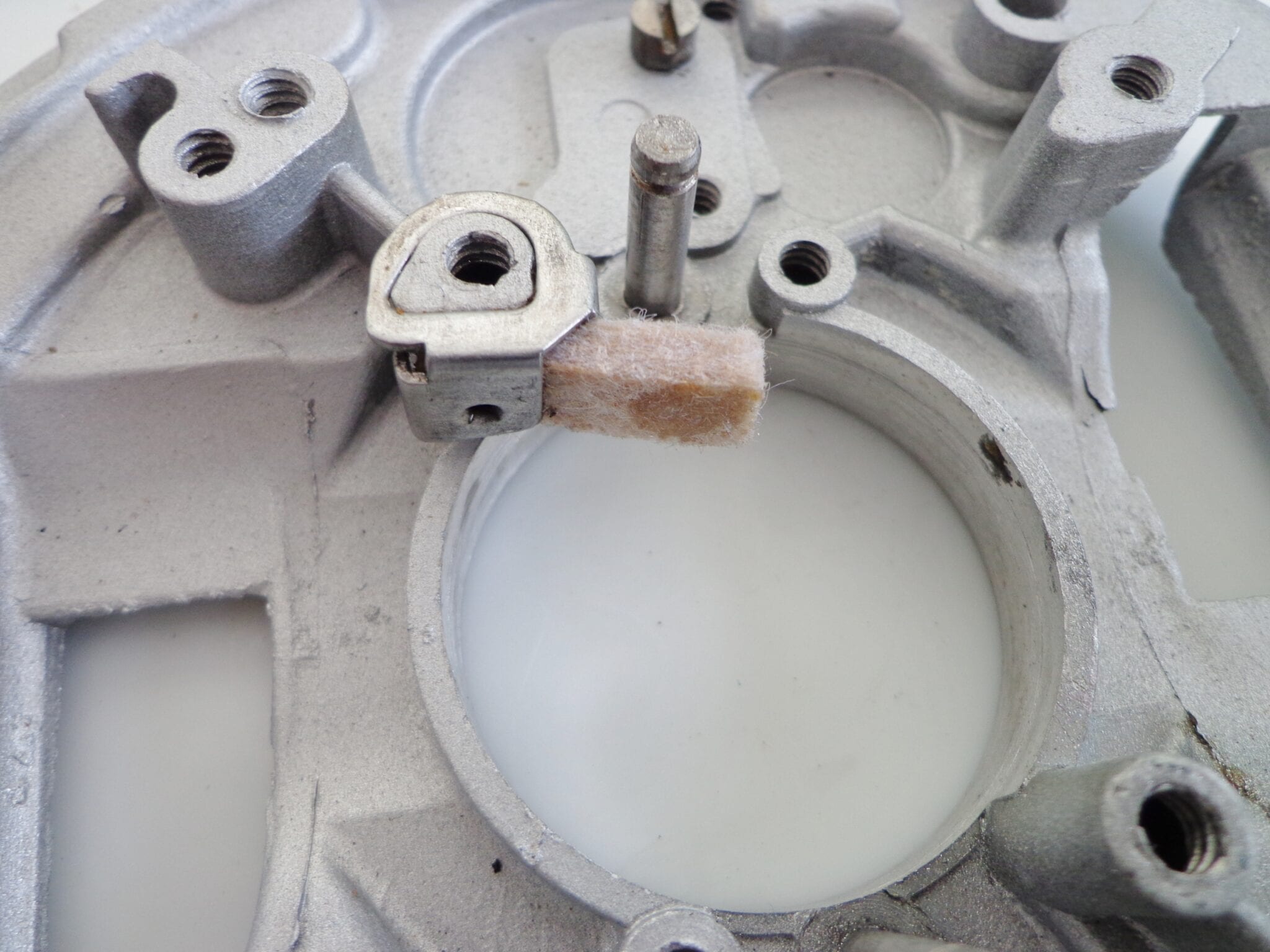

          #237412
            good picture Mumbles … felt retainer clip makes it impossible to rub “against” cam rotation ! “against” ====> to rub on…. 🙂
