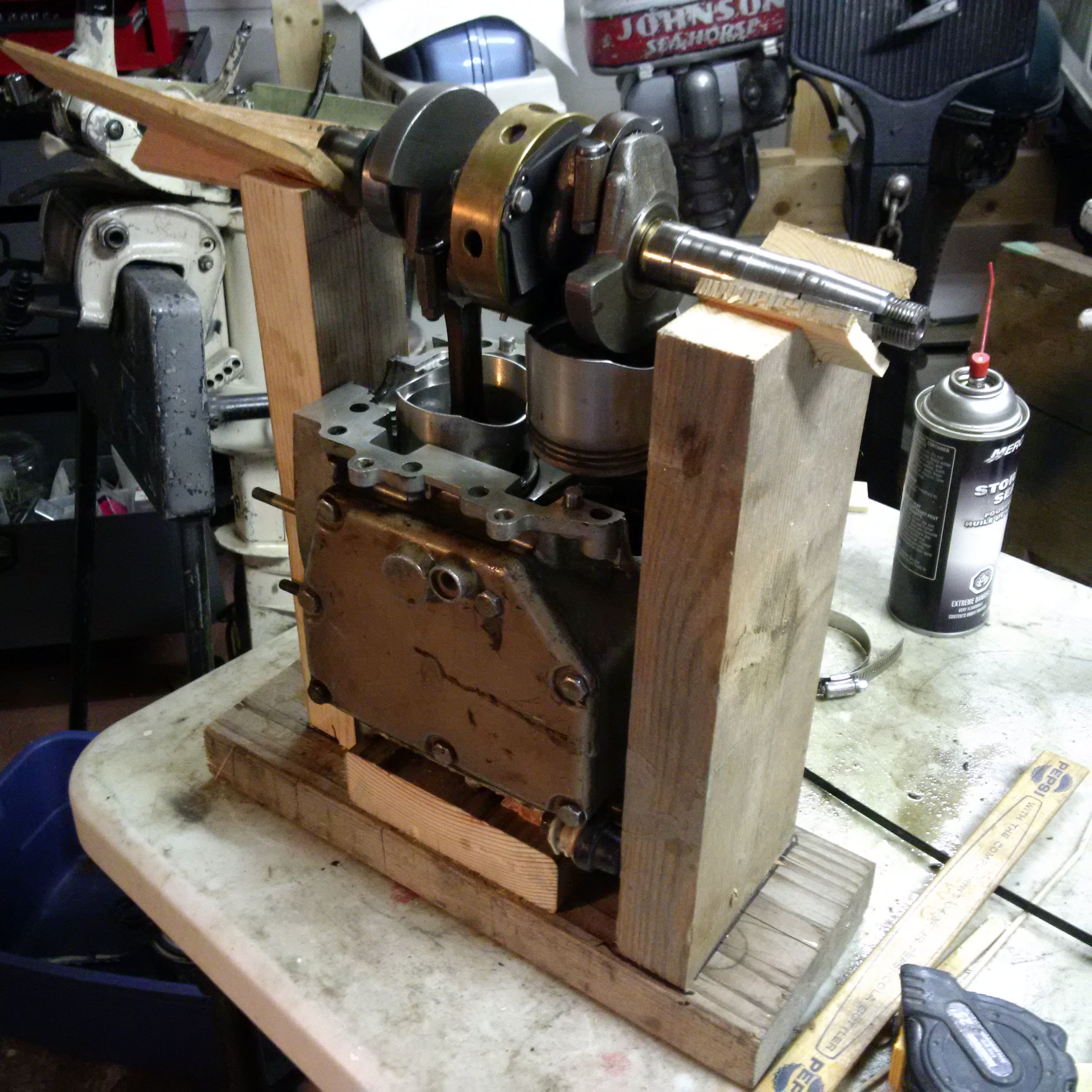

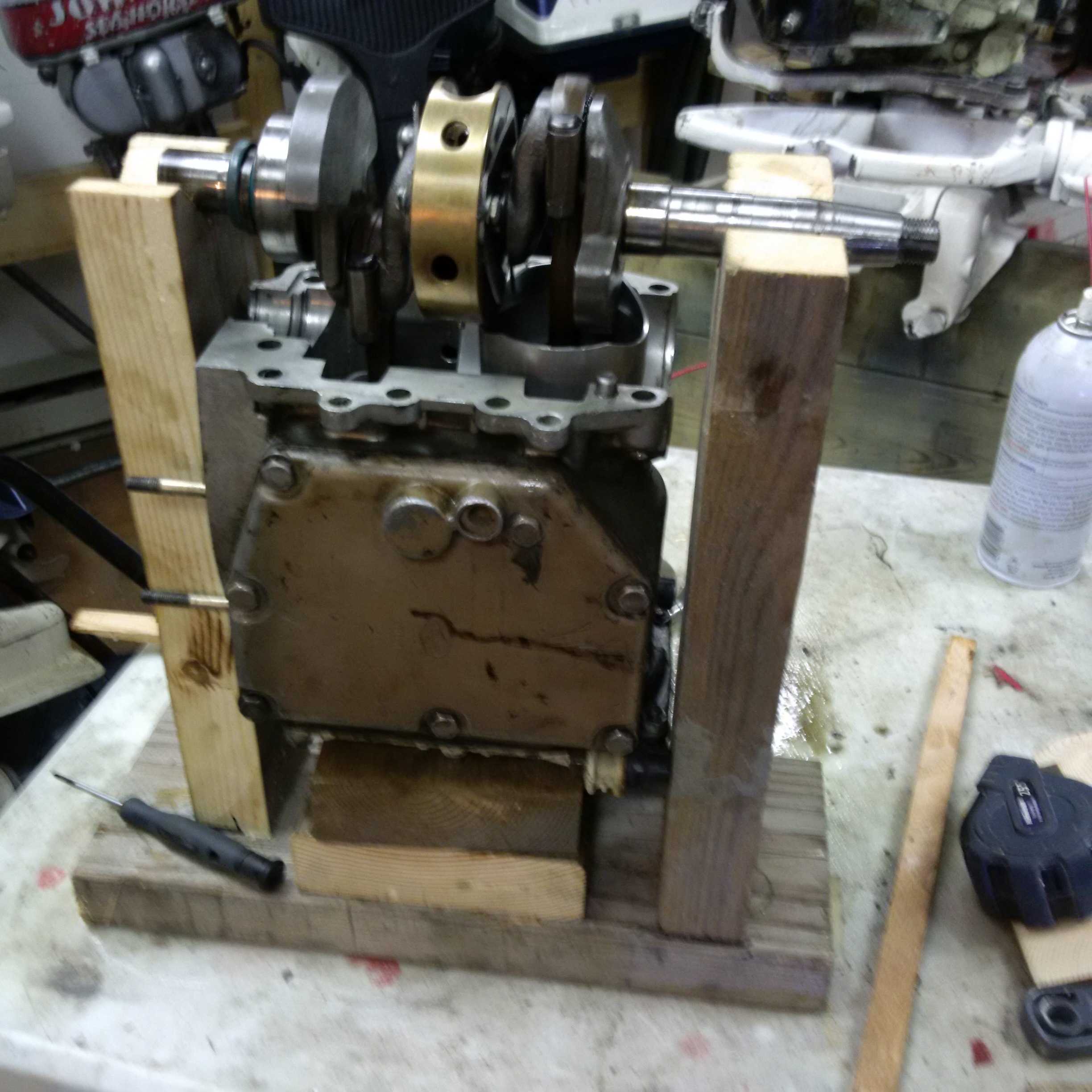

I am coming up with a simple jig to hold the block still and support the crank so I can keep both hands free to poke the rings home . On the lookout for a couple of pieces of hardwood.
November 8, 2016 at 10:37 pm #47186November 9, 2016 at 12:01 am #47194Yay !
Thanks everyone for putting me on the right track. I found I had to jiggle and wiggle the piston "just-so" to get the rings to work themselves into the bore. No way to do that without the jig to hold most of the weight.

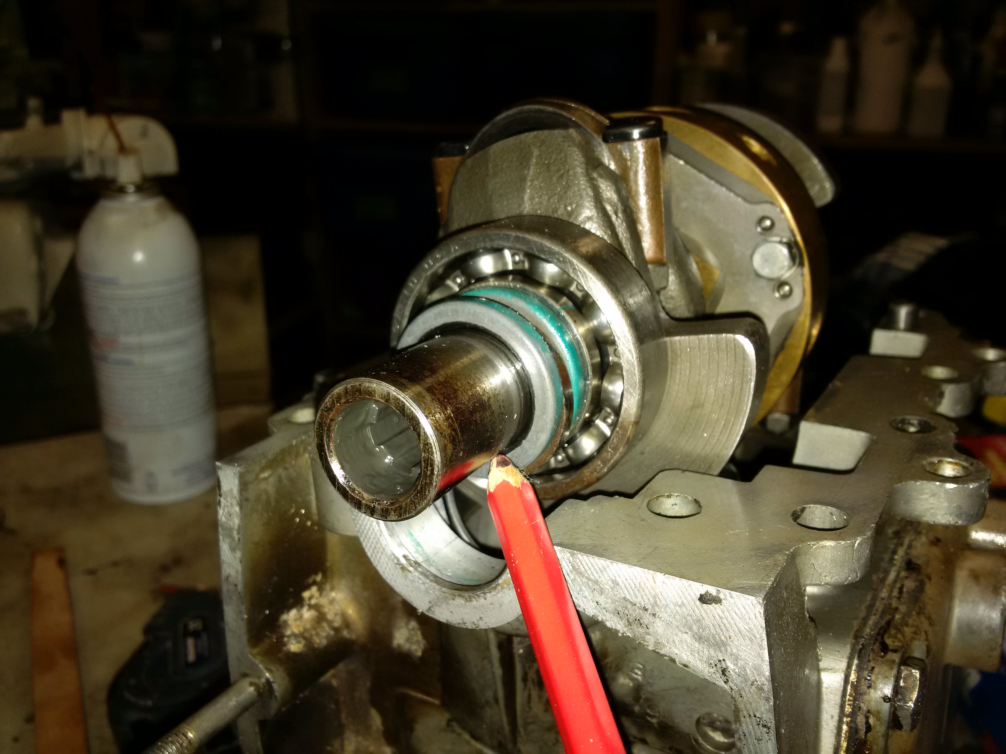

So now is a good time to ask about the correct orientation of the bottom crank seals. Both facing like this?
IMG_20161108_154459.jpg[/attachment]
November 9, 2016 at 1:41 am #47201Glad to see you got them in. Like I said, my confidence was high! 😉 The 26-16977 is the replacement seal. They are double lip seals. I can’t tell from your photo if these are double seals or not. I always install those as original with the open end of the seal facing the retainer, so in other words the other way. Your old seals will have witness marks on them from the retainer.
Steve
November 9, 2016 at 1:47 am #47202Glad I asked Steve. Thanks. I will have a close look and see if they are double seals.
November 9, 2016 at 10:44 am #47214Seal lips face down.
