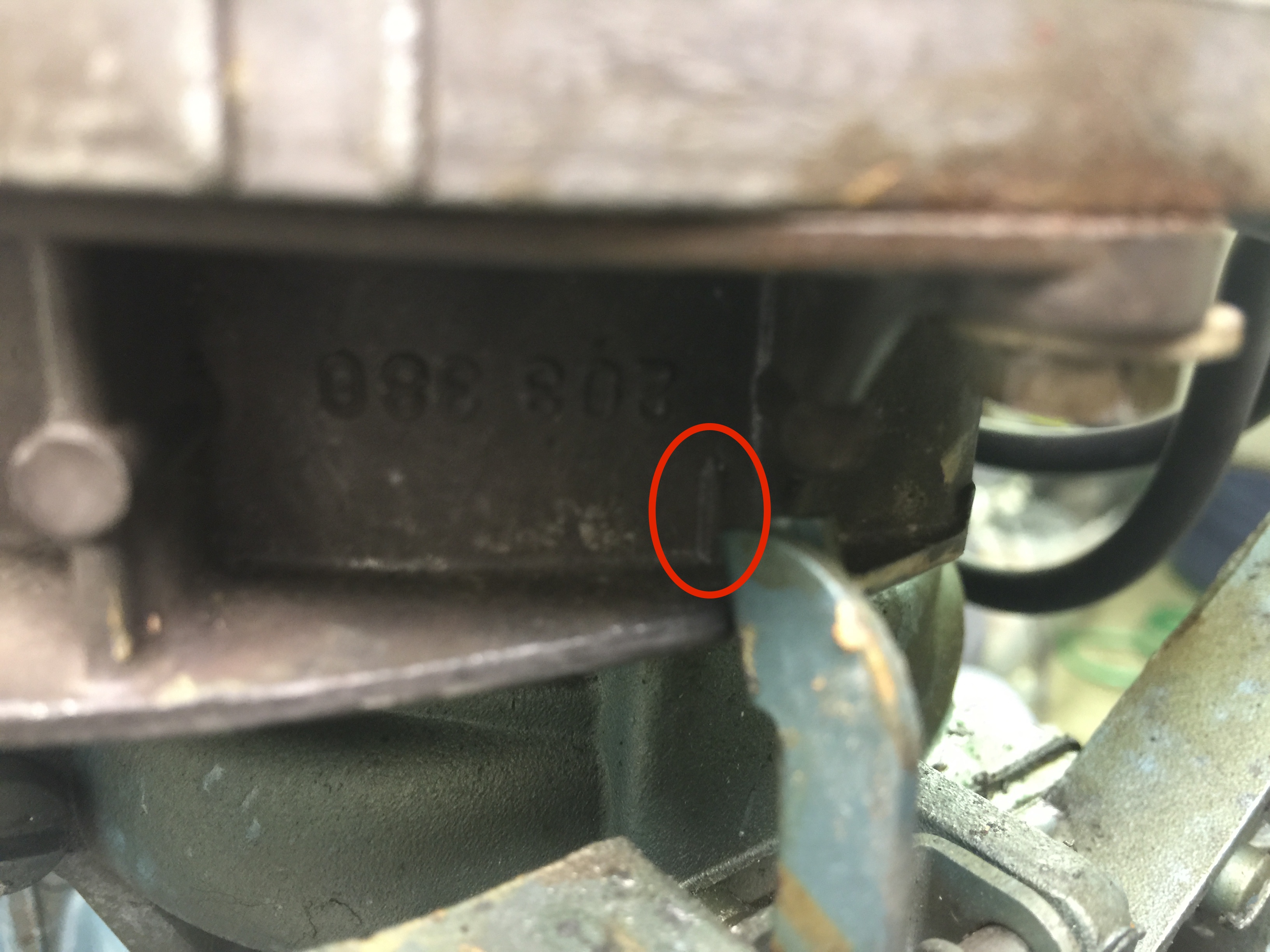

      Home stretch on the tuneup for this 54 7.5hp Evinrude Fleetwin. ($50 garage sale find)
      Is this mark on the cam follower where I’m supposed to set the throttle when adjusting the timing? That’s riiiiight where the throttle begins to opens, so I’m thinking that mark has a reason for existing…
      #62311
        That is the mark for setting the carb throttle timing…not ignition timing I believe…
        #62315
          Correct. The carb throttle should just barely be about to start opening when aligned with that mark. The two marks above and to the left are for setting the points timing with a timing fixture.
