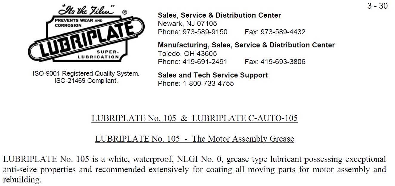

      My info shows Lubriplate 105 as NLGI 0. I would check with Russ Larson at Martinoutboards to see if there are long term implications to using something other than 40Wt ND in it. He would have the experience to know if anything bad happens.

        #42073
        jpatti75
          Yep, I stand corrected, Lubriplate is NLGI 0 not 00. As for using it in your Martin, Russ would know best…I can only tell you what my experience has been. If you’re concerned about water intrusion, the best course of action is to replace the seals and stick with the original recommendations.
