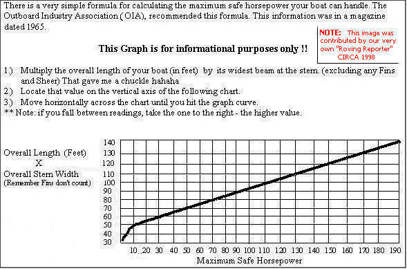

                This is the formula the boat builders used – back in the late ’50s.
                According to that, the boat I ran as a teenager should have been seven feet wide. . . 😆

                  According to that graph my 10 ft x 5 ft wide hydro max Safe Hp is 12 and I use unsafe 30 Hp 😯 😆
                  Pete
