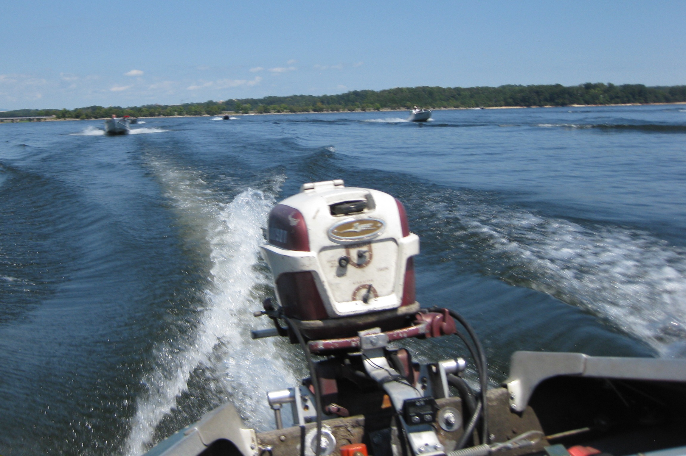

September 7, 2016 at 10:12 pm #43553As a follow up…my Lyman and 1957 Johnson 35hp ran 110 miles round trip Sunday with a 12 pitch…two adults…and three 6 gallon gas tanks. Average 23mph. Topped out around 27 or 28mph due to hull design.
Had a great trip. But I’d still like to go to an 11 or 11 1/2 pitch if I could find one.

That sounds like pretty good performance for that motor and load.
Any idea what rpm @ top speed?
September 10, 2016 at 12:51 am #43712I think it was sitting right at 4500. Going by ear.
I’d like to try a 11 1/2 pitch or 11 just so I can see if I can run the motor less hard. But speed is typically dictated by hull design. To overcome that you must use brute-force. But I’m curious about a little less pitch on this boat.

Here’s some information I gathered on six props I was comparing. All runs were made six times. The tach used was the type that wraps around a spark plug wire and seems to be very consistent. Speed is by GPS. I really couldn’t tell much difference in rpm by ear. I’m not sure who made some of the props but all were in good shape. The boat is a 1958 Feather Craft Vagabond and my motor is a 1957 35 hp Johnson.
8-26-2016 propeller testing.
10 x 14 2 blade brass prop. 4830rpm speed 29mph AJC prop
10.375 x 13.25 file sharpened 4680rpm 29 and 30 saw 31mph twice PropCo prop G-1110.5 x 13 4500rpm speed 28mph
10.375 x 14 4500rpm speed 28mph
Unkown prop 4740 rpm speed 28+mph
Real Carol prop 5100rpm 28mph. must be about 12 inch pitch.September 10, 2016 at 2:30 pm #43730Thanks for the info.
