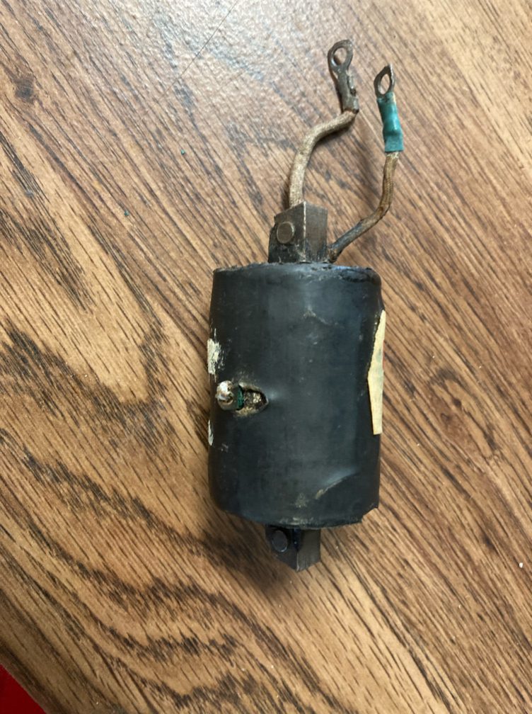

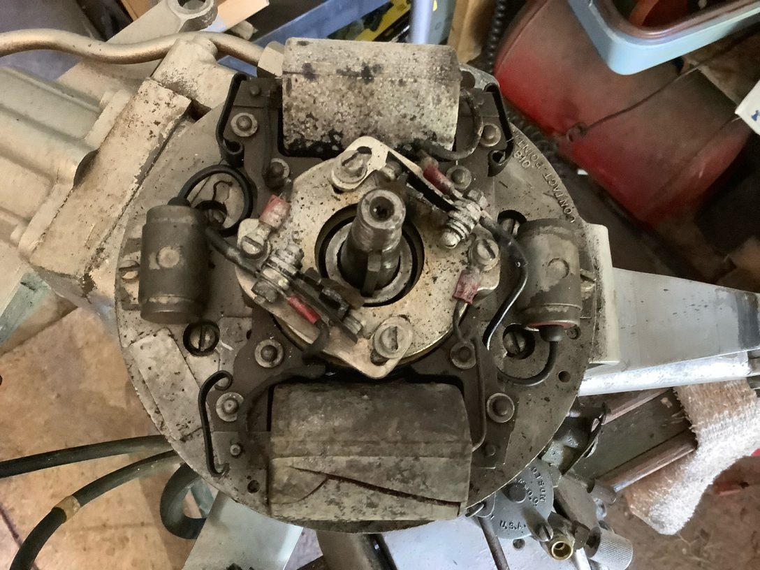

        Thanks for the video but my original coils are different than the ones being replaced in the video. The attached show what mine look like as they sit in the motor and then a second pic shows a spare, non-working coil that’s been removed from motor.
        Given that, do you have any further suggestions? Thank-you so much for your help.

          #249357
            I “think” these may work, but hopefully someone will confirm.
            https://www.ebay.com/itm/284463937035?hash=item423b5f360b:g:U3MAAOSwXKdd-8Fj
            #249440
              Tried to post the following 3 links together for 2
              days. Wouldn’t came up. I’ll try them posting them
              separately. This is what is available today. They are
              the same except for where the plug wire attaches.
              They can be made to work.
              Link – https://www.ebay.com/itm/284463937035
              • This reply was modified 4 years, 4 months ago by Tubs.
              #249442
                Correct NOS ones are available if you want to spend the money.
                This member also offers them with the condenser. Check his listings.
                Link – https://www.ebay.com/itm/133917369301?hash=item1f2e18e3d5:g:VPwAAOSwTHhherHt
                #249443
                  You can also use these. Mounts the same.
                  You just ground out the extra spark plug lead.
                  Link- https://www.ebay.com/itm/133756685510?hash=item1f24850cc6:g:zeEAAOSw3Sla4MKI
                  #249403
                    Tried to post this yesterday- Wouldn’t came up.
                    This is what is available today. They are the
                    You can also use these and ground out one lead.
                    #249584
                    George Solana
                      I received the above coils and I think they will work. But I need to replace points and condensers also. Can anyone steer me to a source for points and condensers? Thanks, you guys and your help are awesome!
                      #249590
                        Keep the points just clean and dress them really well. you ca make a condenser with a capacitor of the same value.
