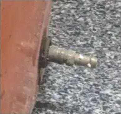

      Ha! I didn’t notice that until you pointed it out. Yeah, that’s a 100% custom job. Maybe another way of introducing air pressure to the tank rather thsn rely on crank case pressure????

        Don’t have a lot of experience with Merc pressure tanks but does it appear that the primer button is missing? Schrader valve used to provide initial priming?

          Good idea Kirk! I did notice the primer was missing initially but didn’t put two and two together!

            How would the schrader valve prime the carb ?????

                    The fitting in the original photo looks more like a barbed hose fitting than a Schrader valve so the tank may have been used as a non pressurized gas tank for a piece of equipment or something.

                      My initial thought was that you could use a tire pump to pressurize the tank as the primer button would. That would be pretty mickey mouse. In thinking about it, it would be better to be at the top of the tank. Not being a schrader valve, a fuel delivery port may make more sense.
                      A question for those more knowledgeable. On a Merc tank, does the “primer” prime the carb or pressurize the tank?
                      Kirk
                      #241958
                        Prime the carb then the motor running pressurizes the tank.
