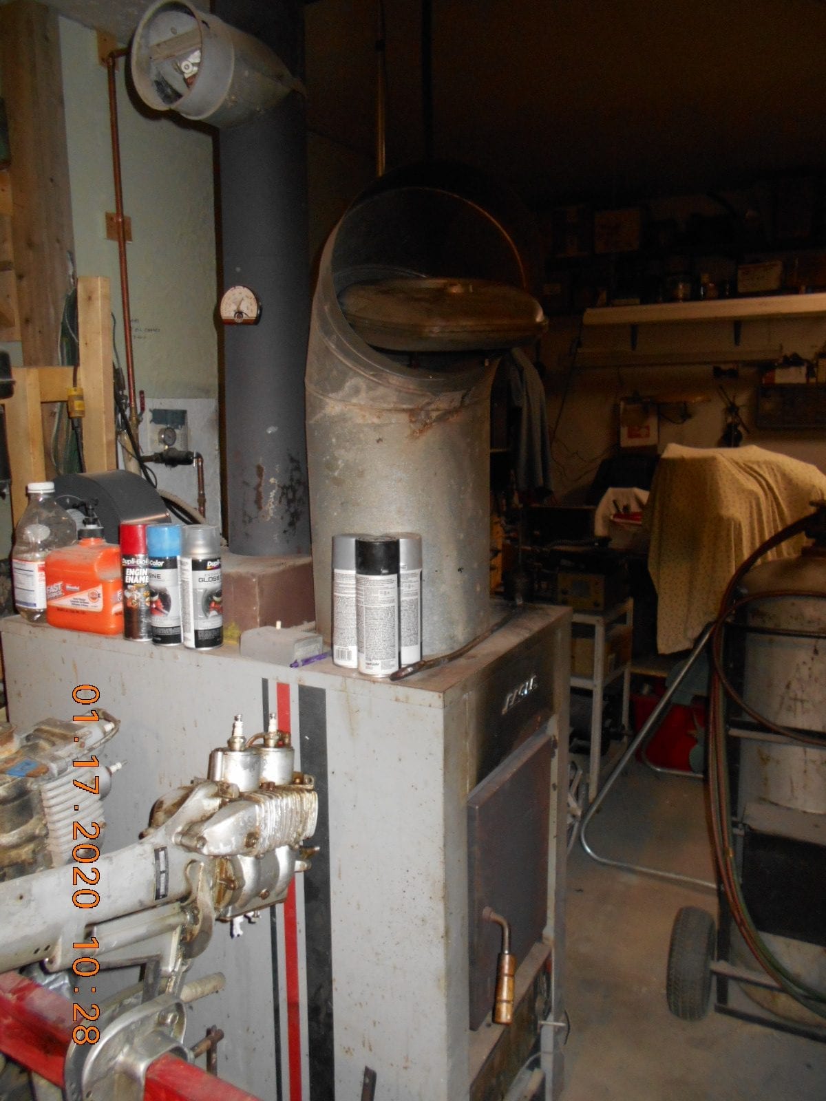

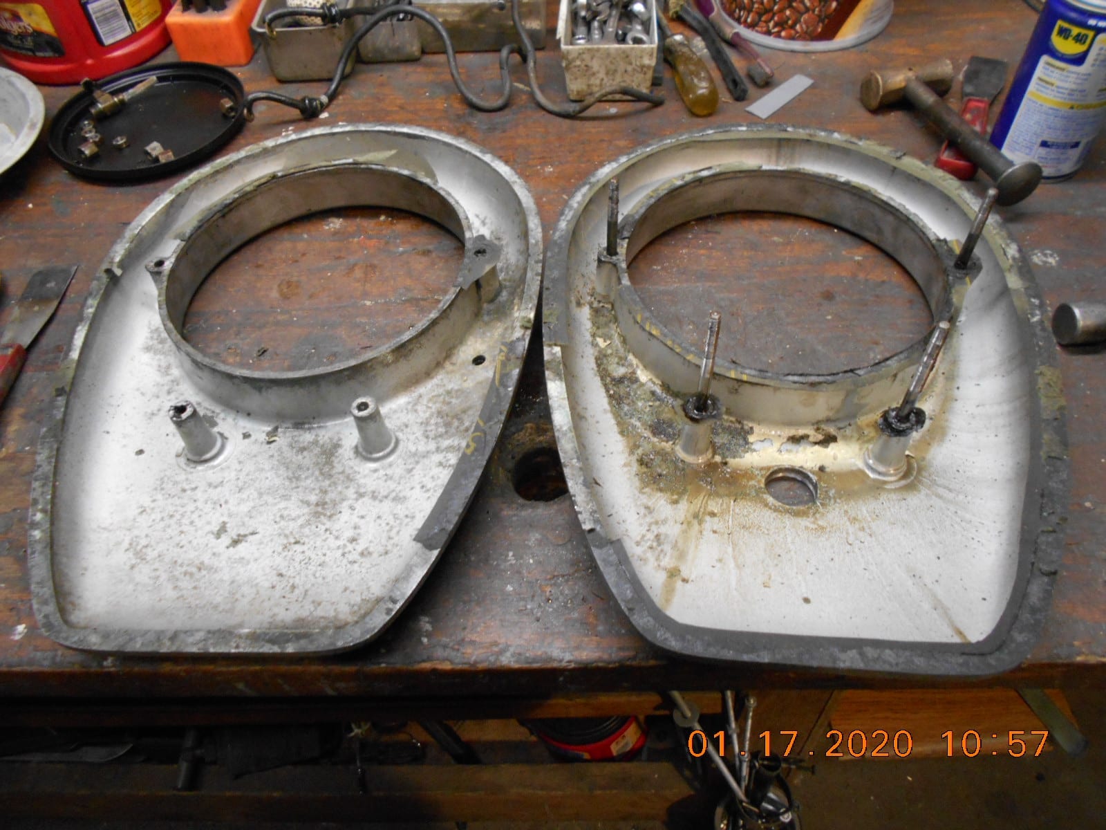

            I just pulled the tank apart a little while ago, after I let it sit
            in the wood stove “hot air” pipe for about an hour.
            It came apart relatively easy, though I have not tried turning
            the studs yet, nor have I looked for some thick glass to
            use for lapping the tank halves.
            DSCN8591
            DSCN8595

              Treat the studs as if you know they will snap if forced, Putting a pipe wrench on them will work IF they are in the mood to be cooperative.
              AND a very BAD idea if they are stubborn. It seems to me you have
              gotten past the hard part, with some careful use of torch and gentle
              persuasion, I think studs will be cooperative,
              The studs are 2 long and 2 short, I have, in past ,attempted to reseal with studs in wrong sport…oops!
              I use the mirror door from an old medicine cabinet… metal back and
              band around edge ,seem much safer than a piece of plate glass.
              Found in trash many years back, kept it ,as something too good to
              throw out , only took 25 or 30 years to fine a use for it…spent about 3
              weeks looking for it when I realized its time to be of use had arrived.
              Louis

                  #192448
                    All the studs in the tank came out with ease. Whacked each one with the brass hammer,
                    got the torch out, and within three minutes had all four loose, then soon removed.
                    Wish it was always that easy!
