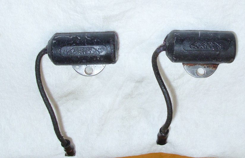

If the condensers look like this, they are the originals, and 99% chance they need to be replaced.
October 1, 2025 at 5:25 pm #300286I still think that the issue is condensers, but the flywheel nut was too tight to remove with an adjustable pipe wrench, even when held very firmly in place, and I am not going to bother spending too much effort on it….I’ll just get one that runs good so as to avoid completely ruining my experience with mercs.
