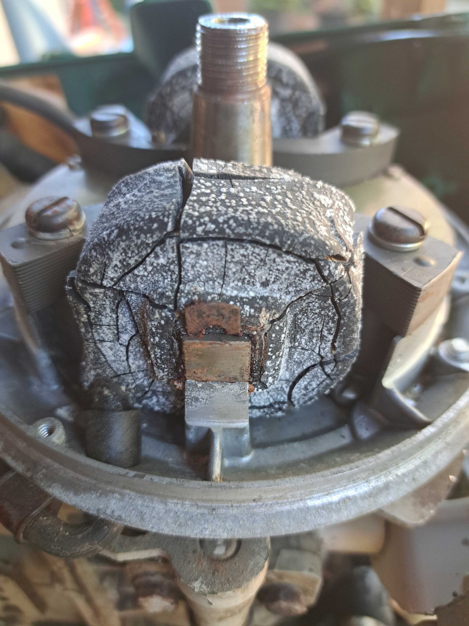

      Hello,
      I finally am getting around to restoring my lapstrake boat and outboard.  I have a Mercury Mark 25E.  Here is a photo of the coils:
      Here is a close-up of one of the coils:
      20250723_175723
      My question is, does anyone have a line on replacement coils?  Please let me know.
      Russell
      #298460
        Here is a link to what I did on this motor. Stay away from the black coils as they can be glued to the laminates.   https://youtu.be/OxPHe8EPe1Q?si=pP8yToaDDgQ1Izzz
        #298489
        green-thumbs
          Repco Phelon coils MAY be out there, but, the OMC “Universal” magneto coil are available at reasonable cost, Adapting the magneto plate and coils is not
          difficult, but, it is not a Drop In. Some fit and try along with some creative ignition wire routing required
          There are articles on the
          conversion around if you can
          find,
          Louis
          #298500
          Russell Bardak
            Thank you Tubs and green-thumbs for the suggestion to adapt OMC coils. This is likely the approach I will take.
            Russell
