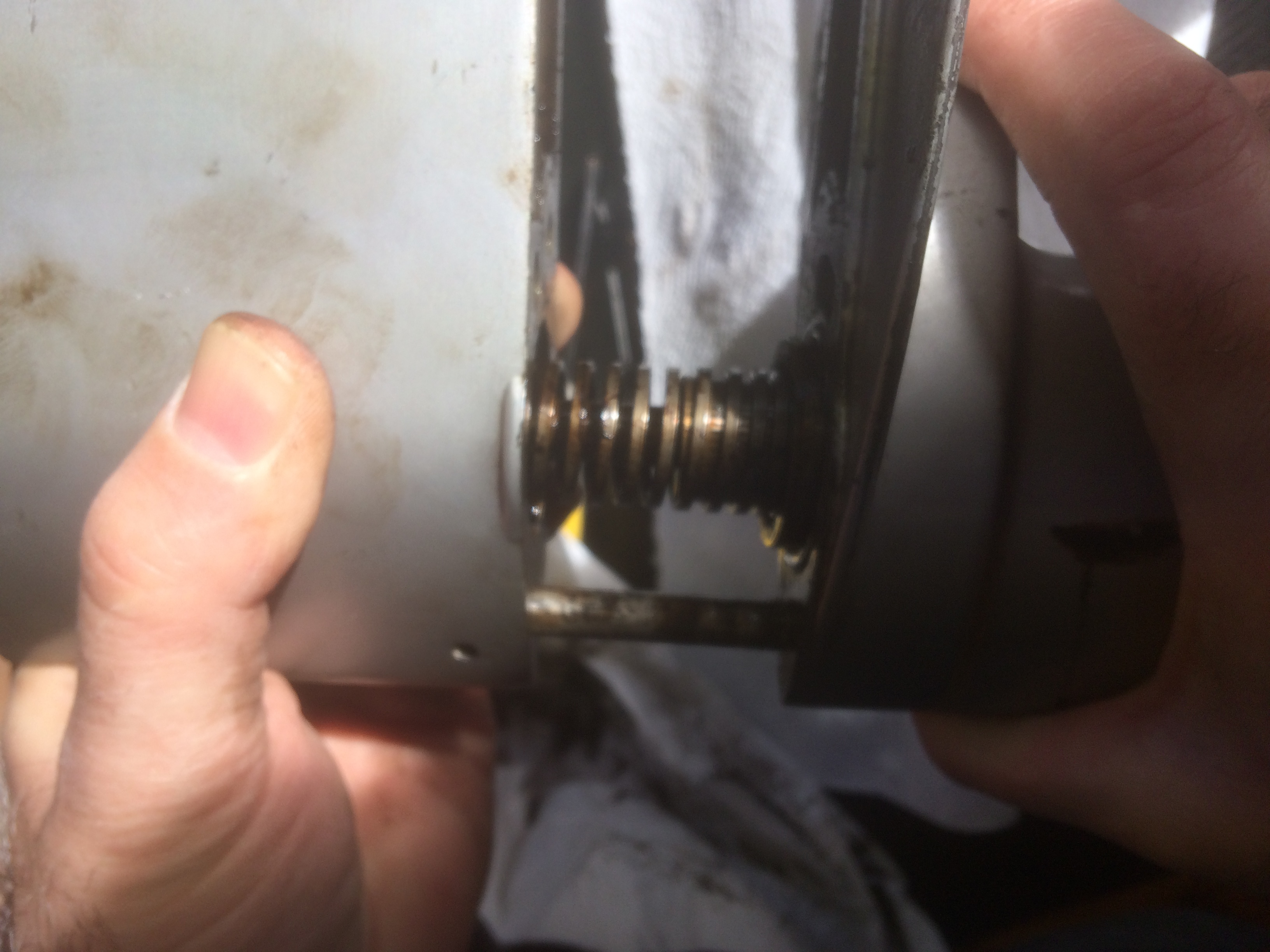

          cheetahgod
            I’ve gotten the lower unit off the mark 5. How do I disconnect the bottom gear housing off the upper part? It seems there is a large spring preventing the two parts from separating.
            #52070
              Phillips up in the exhaust snout.
              #52072
              cheetahgod
                I took that screw off already.
                #52073
                cheetahgod
                  I took that screw off already but the spring is still attached
                  #52074
                    turn the drive shaft backwards to loosen the spring but hold the prop shaft .
                    #52075
                    cheetahgod
                      THANKS. It worked
