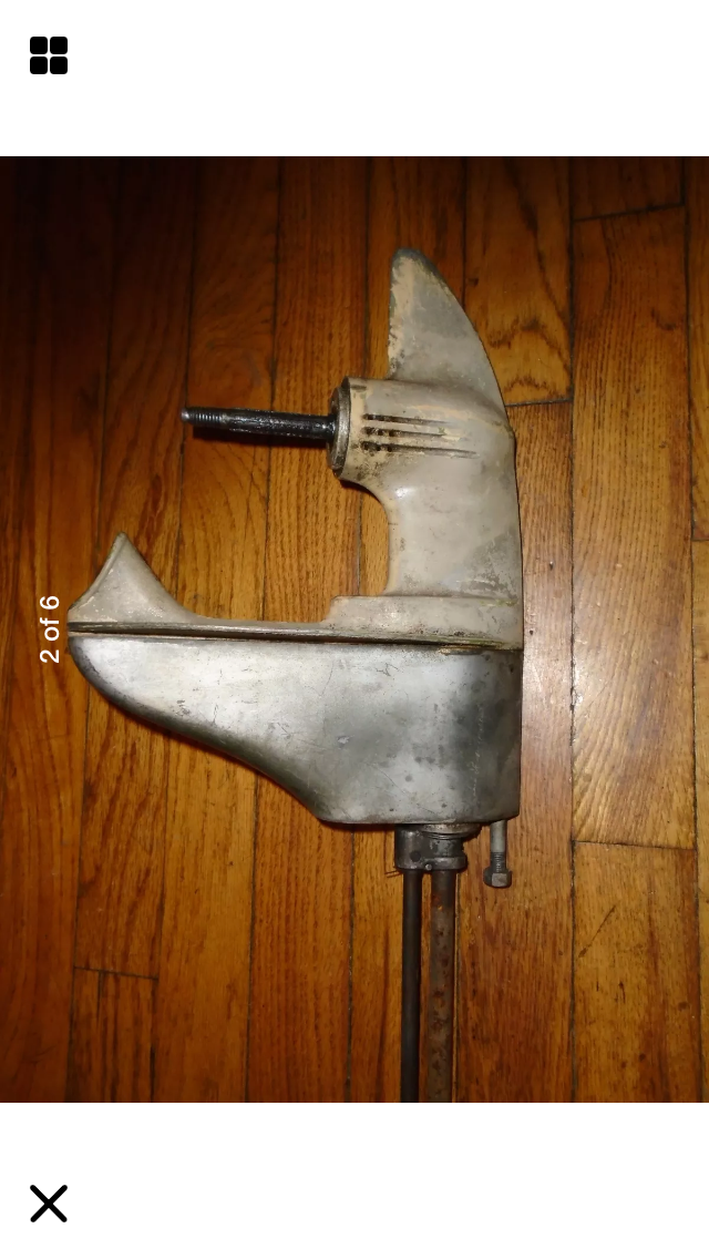

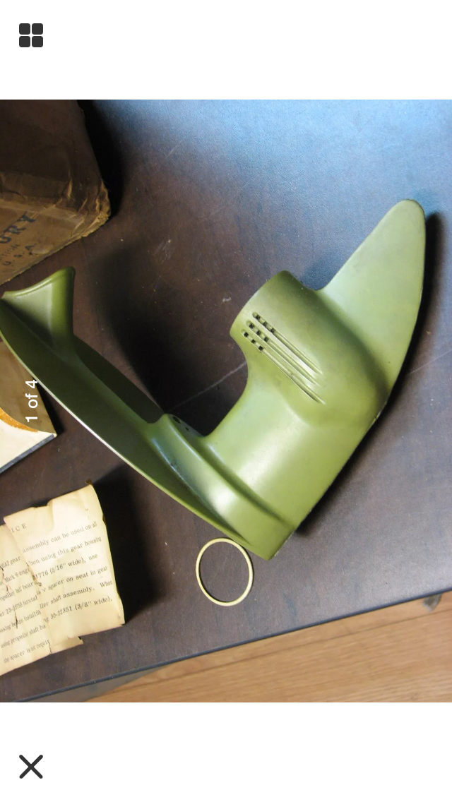

        Which would be better to buy. They’re both the same price.
                      Unless you feel comfortable with rebuilding the lower unit, I would most likely suggest you get the used unit that is complete. Once you get your feet wet into the hobby, you will be more able to tackle challenging projects. The Mark 5 is an excellent motor, but they are more complicated than the KF-5 that they replaced. As Dave Bernard has posted his contact information for you, and generously offered his help, I would get the complete one, replace the water pump, and move on to the rest or the motor.
