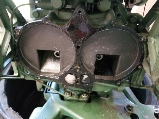

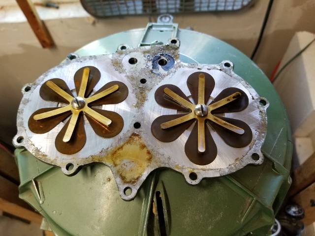

I have attached pictures of the reeds. None of them were stuck. I see nothing wrong but please look and tell me if you see anything.

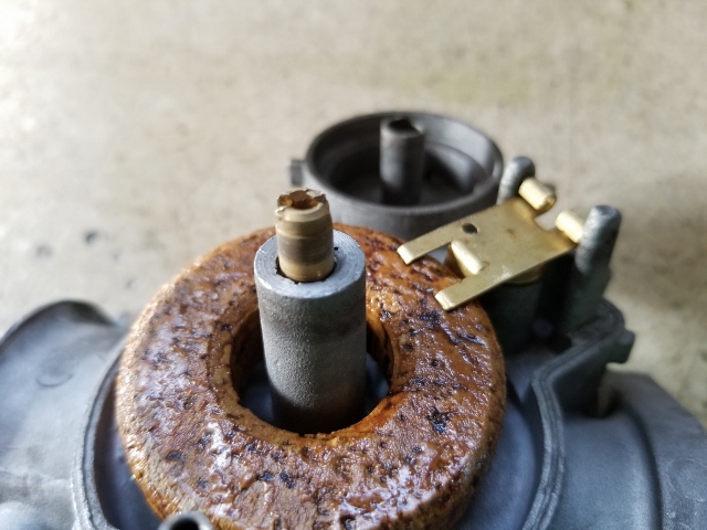

Also, I took the carb apart. As you can see the float looks new. BUT.. isn’t there supposed to be a felt type washer around the jet? I don’t have a parts manual for this motor so I am not sure.Also, I went back and re-timed the motor using Franks "special tools" but there was no change in the way the motor ran.

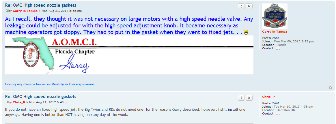

so, now I am not sure where to go next.May 17, 2018 at 3:10 am #76161quote Huntleybill:UPDATE: isn’t there supposed to be a felt type washer around the jet? I don’t have a parts manual for this motor so I am not sure.In a previous post it was mentioned "The first time it’s listed in a parts catalog for an RD/Bigtwin is in 1961" but some use one anyways on earlier motors.
viewtopic.php?f=2&t=13554&start=10&hilit=nozzle+gasket#p71399
http://www.marineengine.com/newparts/pa … OMC0307778
And I don’t see a pin holding the float on.May 17, 2018 at 3:57 am #76166There is a pin, I just took it out to inspect the needle and seat.

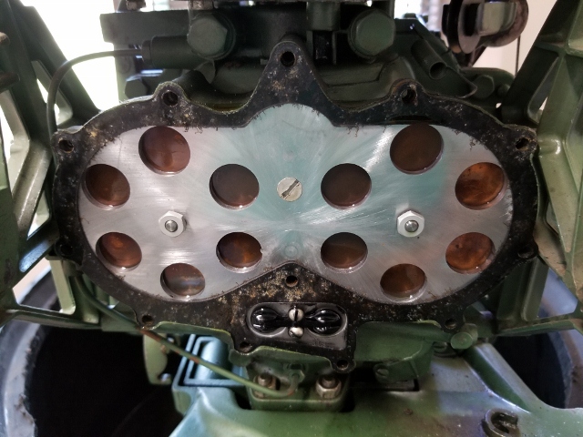

May 17, 2018 at 11:29 am #76178Wonder why there is so much more smoke & soot in the lower chamber than the upper one?
May 17, 2018 at 8:47 pm #76195quote FrankR:Wonder why there is so much more smoke & soot in the lower chamber than the upper one?Am wondering the same thing…Is this the cylinder that isn’t firing?

May 18, 2018 at 2:10 pm #76235Water ingestion from the exhaust cover came to mind here too. But I didn’t say anything—till now. Those motors had an aluminum baffle plate between the block and outer cover. They are known to develop pin holes, which allowed water to squirt into the exhaust ports. Normally discovered too late, after the powerhead is destroyed by rust.
