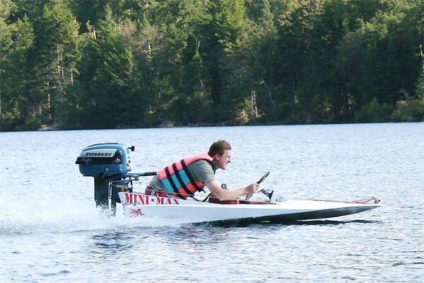

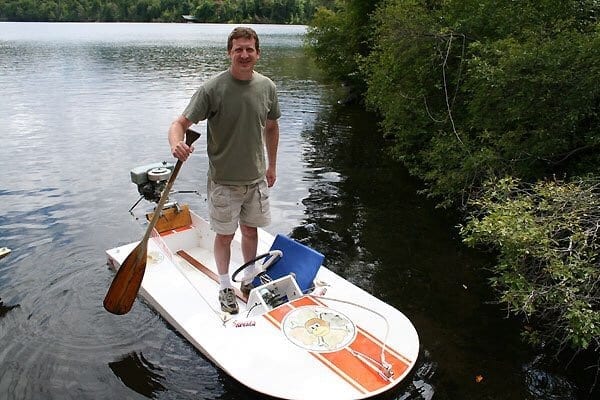

          I have run my mini max with everything from 3 hp to 15. Speeds ranged from 10 mph to around 33 mph. All fun. Yes, a very wet ride, don’t wear clothes you don’t want to get wet. I prefer a motor with the tank attached, not much room for the remote tank as you see in the pic with my Evinrude 15, tank is between my elbows.
