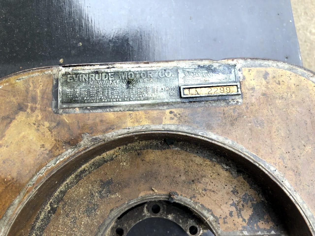

      Hi I am new to the forum and am looking for help identifying a motor. Unfortunately my father recently passed and in cleaning our the basement I came across an old outboard motor that I would like to identify and hopefully bring back to life in my fathers memory. Unfortunately I do not know anything about this motor. I recall my father mentioning that he obtained an old motor years ago but that is it. I appreciate the help and look forward to the journey.

          If I’m reading the motor number correctly, a Model L 4hp from 1925.

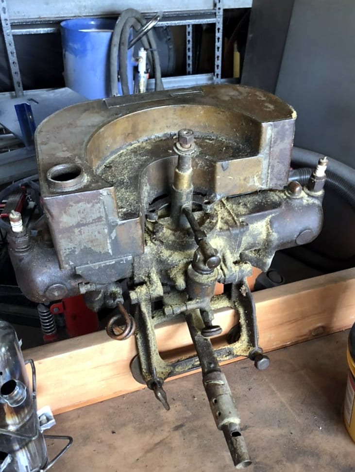

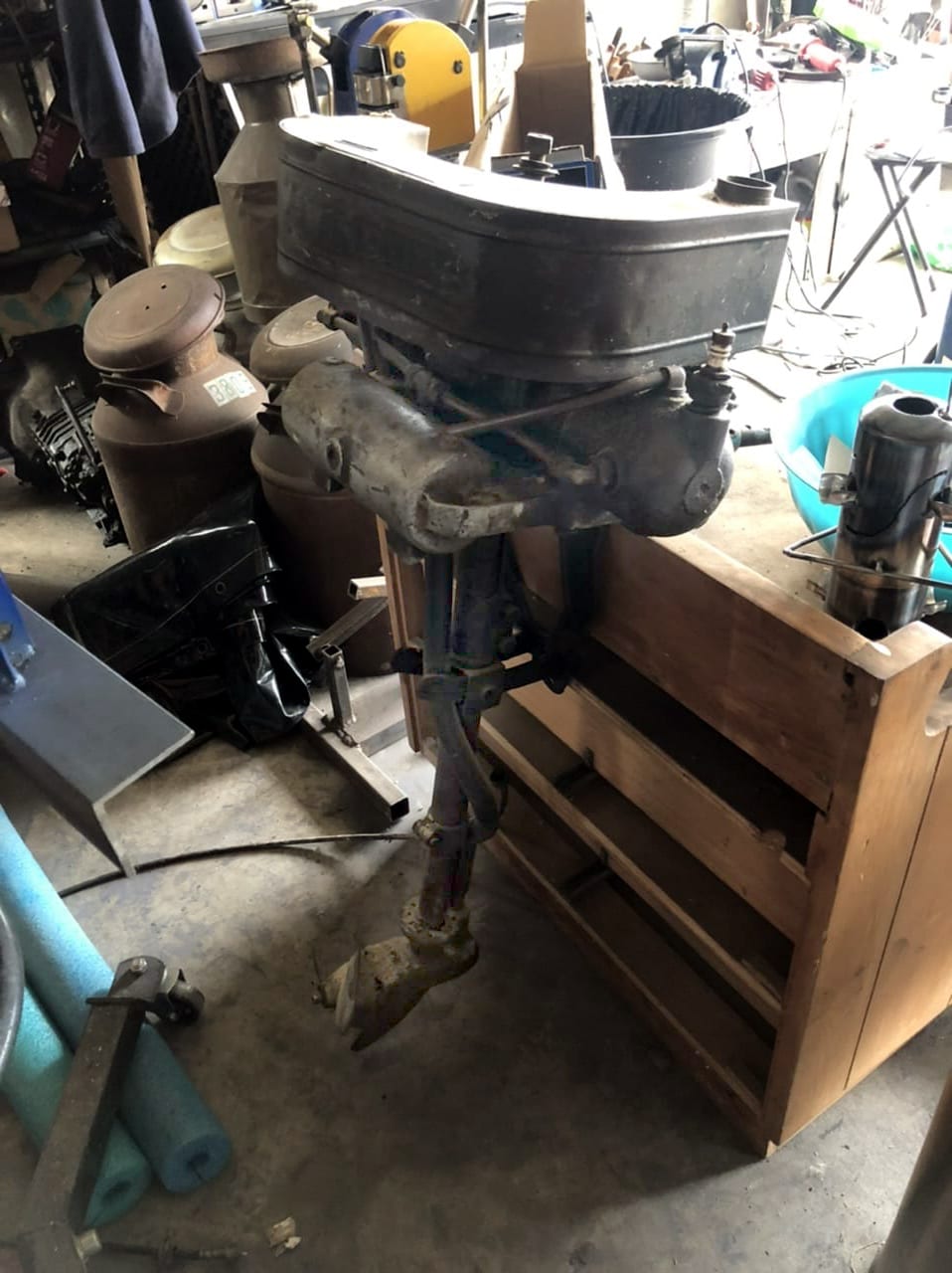

            Definitely an opposed twin and not your garden variety Evinrude single. Interesting!

              It’s an evinrude model LA
              I’d have to consult my book for the year when I get home.
              Not a common motor.
              #241508
              lyks2tinkr
                It’s an Evinrude model LA big twin. 4hp. The serial number is from later in 1925. Weighs 80 lbs.
                Yours appears to be missing the magneto and flywheel unless you have it off to the side.

                  Hi thank you very much for the information. Unfortunately I am missing the magneto and flywheel as you mentioned. I am sure they are not an easy item to locate. Any further thoughts as far as areas to start looking for parts, manuals etc would be greatly appreciated.
