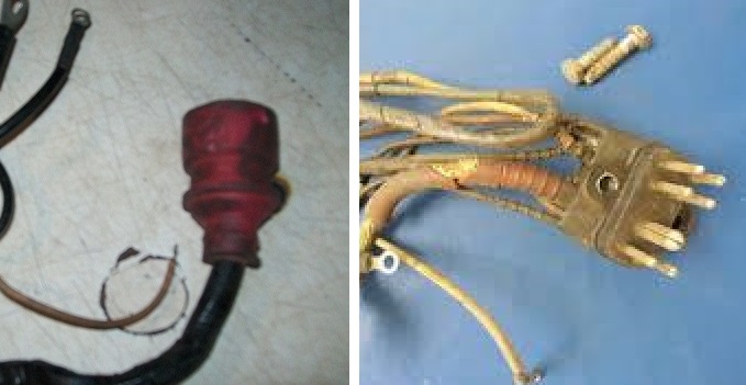

The motor has a harness cable coming out, about five feet total length, with two battery cables, maybe #4, and a connector with seven of what looks like 1/4" female spade connectors captive in it. Are these the "quick disconnects" you are talking about?
Alan
October 6, 2016 at 3:11 am #45287yes – – – somewhere back on the engineer’s drawing board,
someone thought those Big Twins would be taken on and off
the boats frequently – – – subsequently, the quick disconnects.
Now, if you do not plan on this event, it is prudent, but not period correct,
to eliminate them…. I have seen 5 of the quick disconnects and have 3 sets in a box.
all the wires and pins are toast. No way would I run 12v high amps through them.
but – your motor – use your own best judgement on how to proceed.
Just sharing some thoughts on the subject.October 6, 2016 at 5:06 am #45293The one on the right looks like a pin-and-sleeve connector. The one on the left looks different (?). In any case mine has a different setup. The harness is continuous and I think it must have plugged into a box containing a starter solenoid and some other stuff. If there was a generator did its regulator have a separate box? I’m comfortable with electrical work but have never had an outboard with wiring before. OMC definitely did not skimp on the gauge of wiring.
