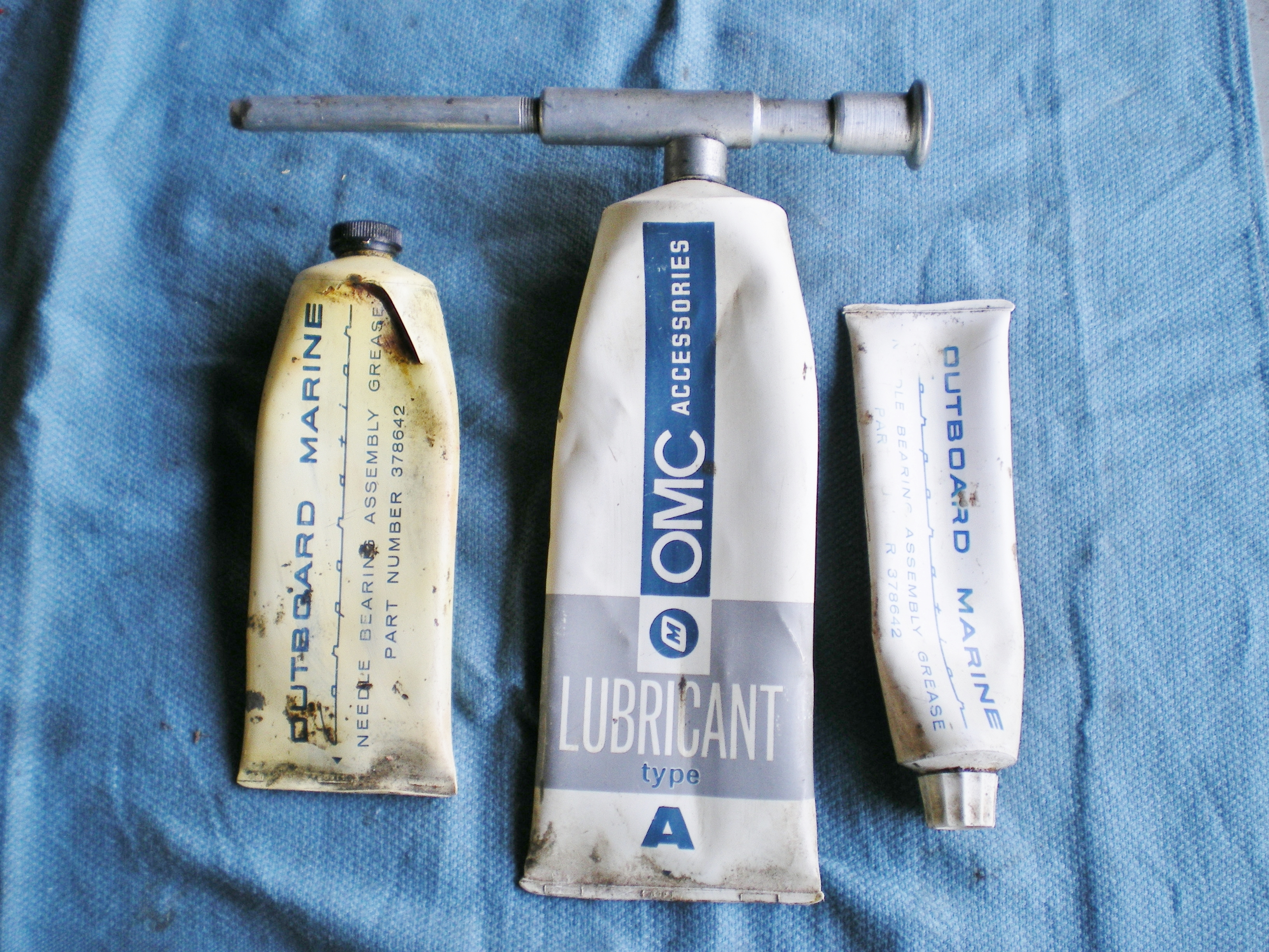

            If you can find one of these push type of grease guns, it will fit all of the fittings on any outboard motor. I think they still make them.

                #48741
                  mumbles….. I have one like that….somewhere….It was my first grease gun years ago… now I have to find it ๐Ÿ˜†
