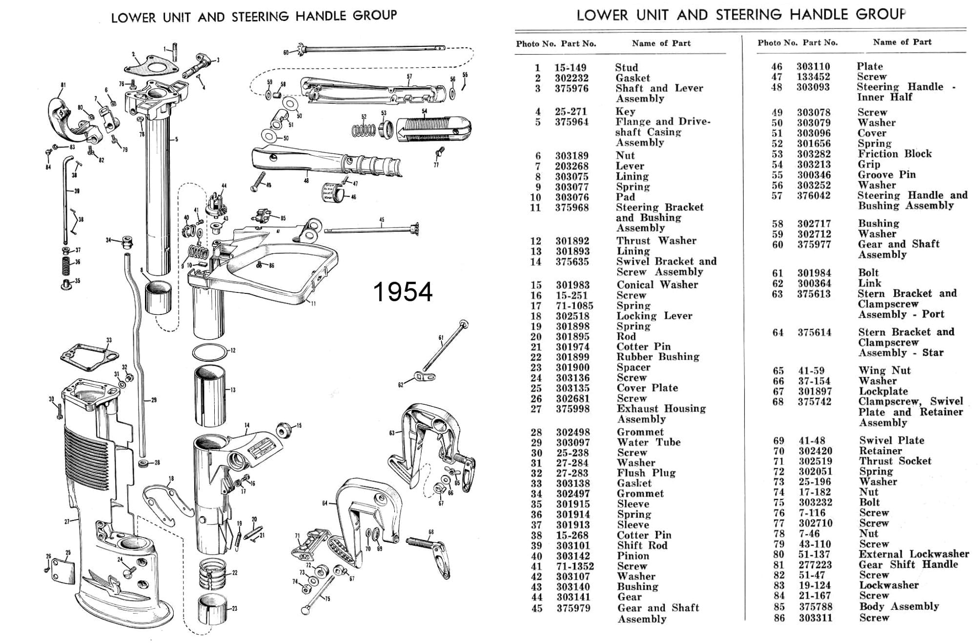

      Anybody got a picture of the “lower unit and steering handle group” page for the year 1954 or 1955 QD? Thanks for any help!

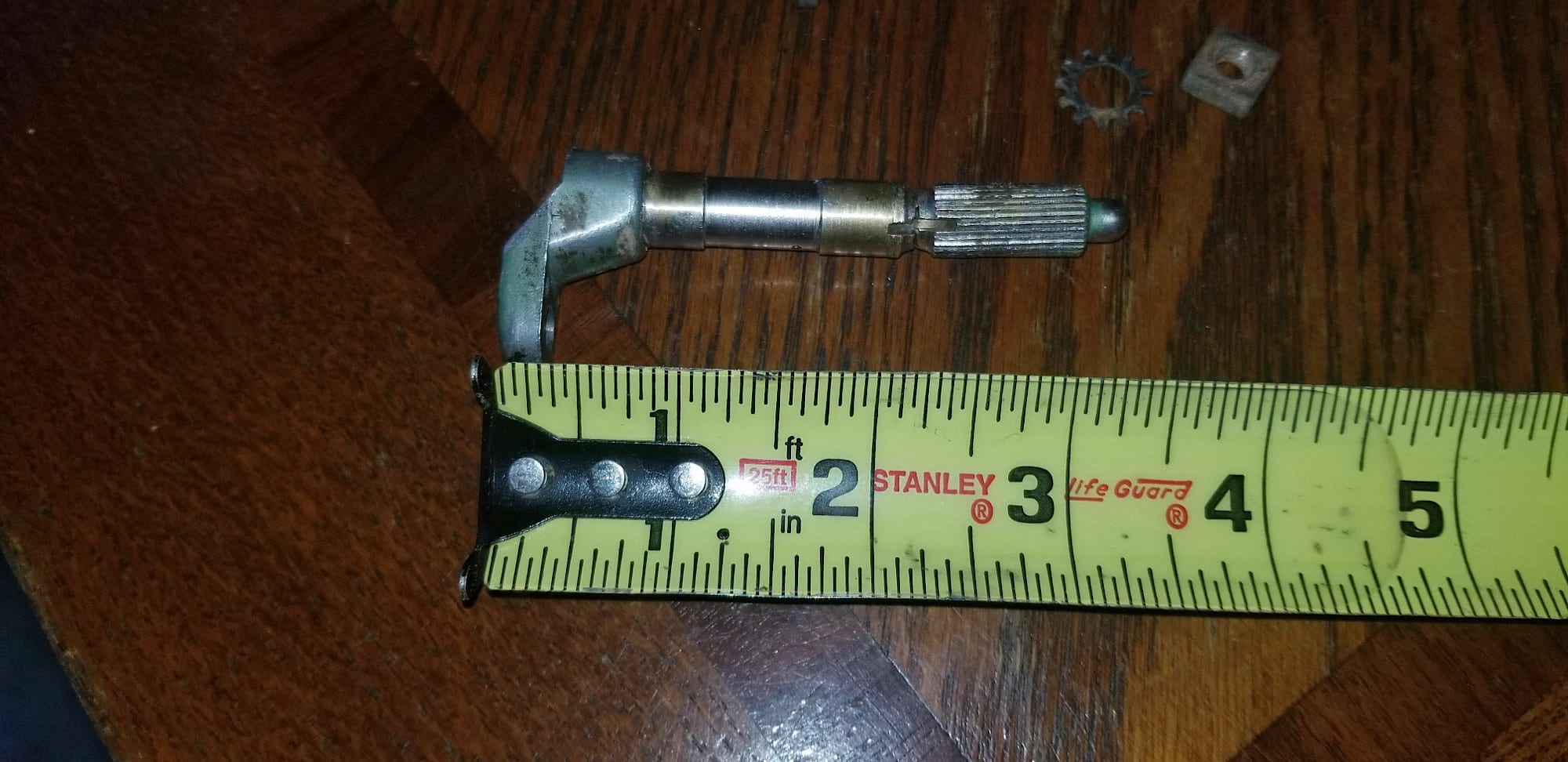

      Here’s a pic of the part. It’s gotta have those ridges on it.
      Let me know if anyone has one you can spare? It’s for a father/son project of a friend of mine.
      1C09A210-253B-4BFE-9EAD-97D483CD5A48

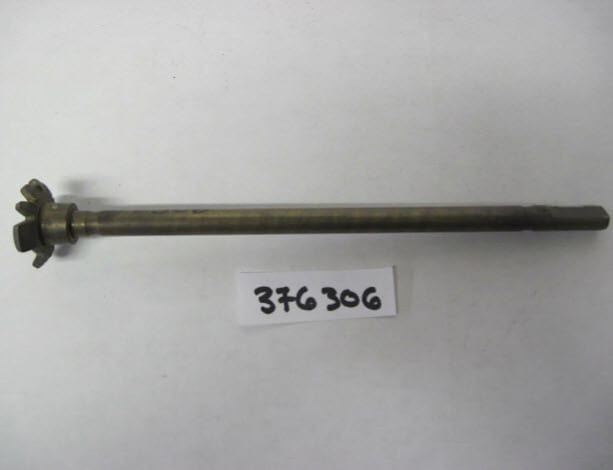

        p/n is 376306 and is still a good number. I do not have one
        #210357
        opposedtwin
          I don’t think that’s it Ed. When I put that part number in at Marine Engine, it comes back with a gear shaft. Although I guess they could have the wrong part under that number……..
          F4CA51DB-461D-476A-84CC-B5E276156863
          • This reply was modified 5 years, 7 months ago by opposedtwin.

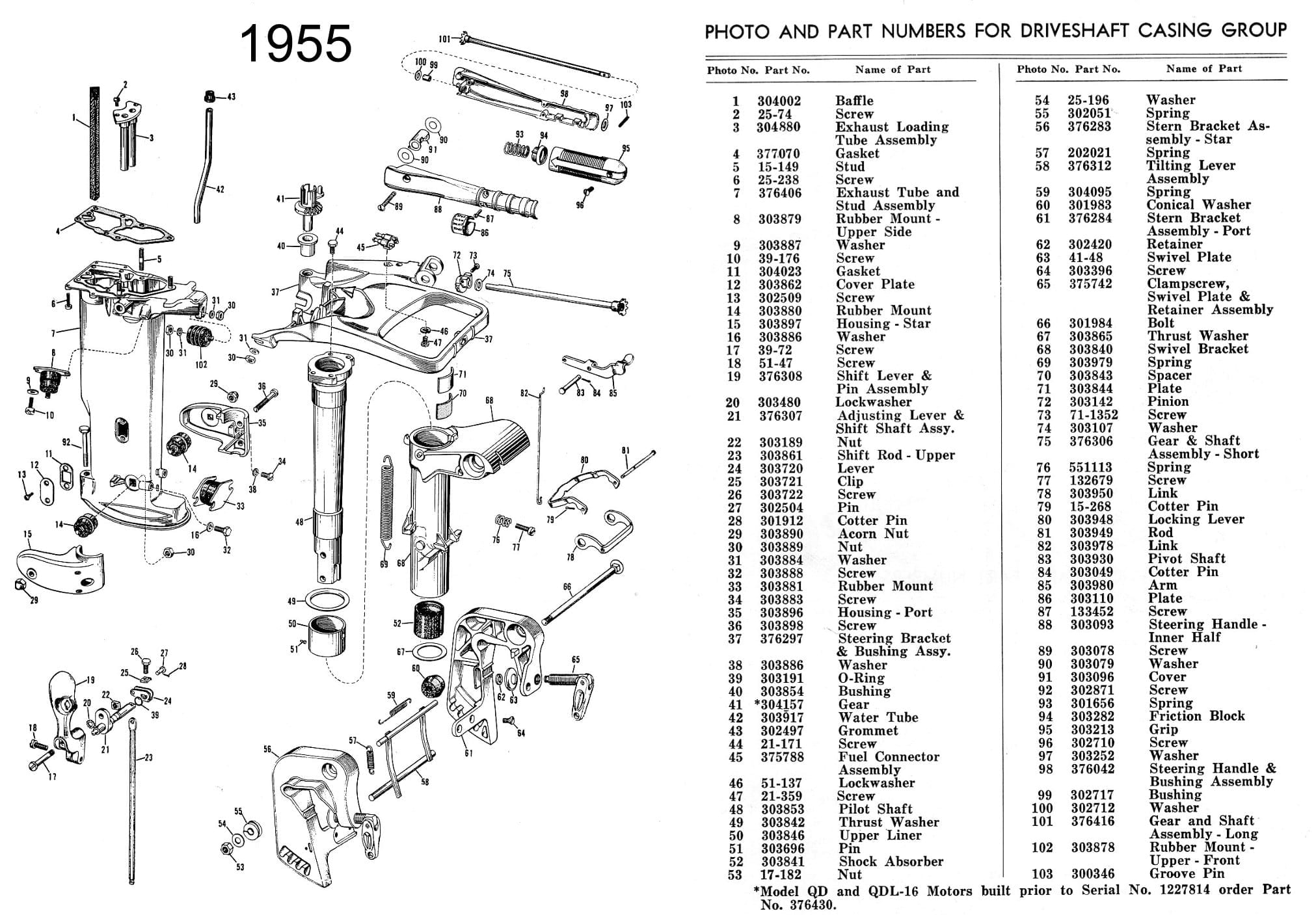

            how about 376307, fat fingers at work, sorry about that

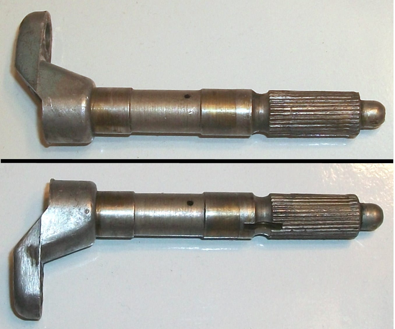

                  Scott, ’54 and ’55 were different as you suspected. I have one from a ’54 I can send you like your picture (375976). The ridges are mostly ok and should be enough for the handle to grip to. I’ll check to see if I have the one for ’55 if you need that one (376307).
                  lever
                  1954
                  1955
                  #210378

                      That’s right Scott. “54 is distinctive with the embossed Sea-Horse on the exhaust housing, ’55 has the 5-bolt lower unit.
