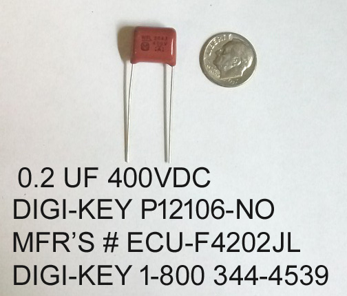

        I purchased and tested 10 of these digi key panasonic orange drop capacitors in this thread with my ST-75 Stevens Ignition Tester. They tested fantastic especially for the leakage test. They immediately were in the correct range for the leakage test where normal condensers take like half a second to get there they are there immediately. They also tested correctly for capacitance and resistance tests.

                  Okay I was just curious which ones you had tried and who made them since they didn’t work.
                  The ones I tested are the ones FrankR uses and they tested very well if not better than an actual condenser. I will post his picture again these are the ones I tested and I got mine from digi key like he does they are made by Panasonic which makes reliable electronics.
