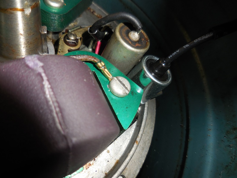

      Oh wow, you got lucky. Those coils have been replaced and should be just fine. But tuck the ground wires back so there is no chance of rubbing on the flywheel hub.
      #30648
      reivertom
        I wouldn’t replace a thing…..just clean and adjust the carb, check the fuel lines and start cranking. You might get lucky and have a good runner "out of the box"..
        #30652
        1946zephyr
          +3 on that. Your ignition system looks great. Clean and adjust the points and call it good.
          #30653
          david-bartlett
            Nice little stand too!
            #30657

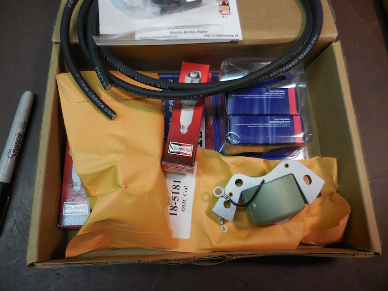

              Are those the tall 581419 condensers in it? The new replacement coils should be matched up with the short 580321 ones.
              #30723
              scoot
                Thanks guys.
                Mumbles. The condensors in the motor are taller than a new kit I have for a BigTwin.
                What happens if you put shorter condensers in?
                Anyone know flywheel nut torque specs?
                #30750
                  Your new condensers should work just fine. Torque is 40-45 foot pounds.
