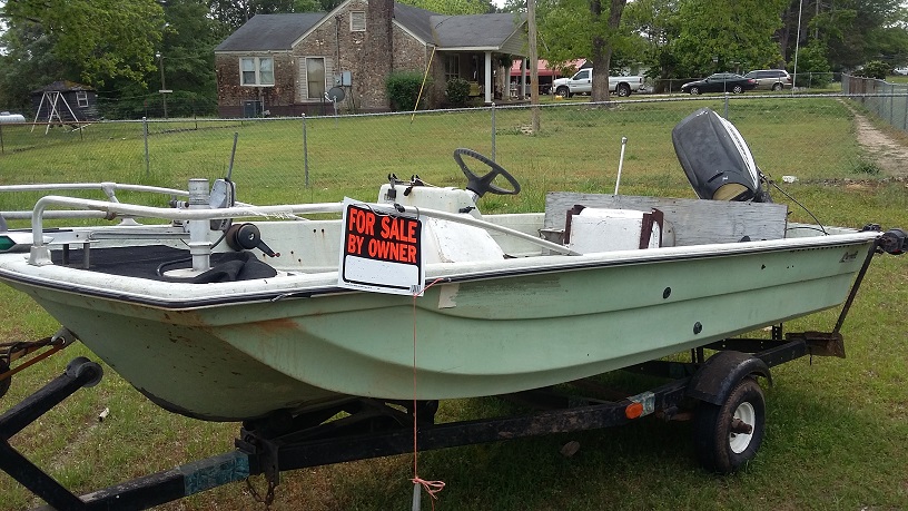

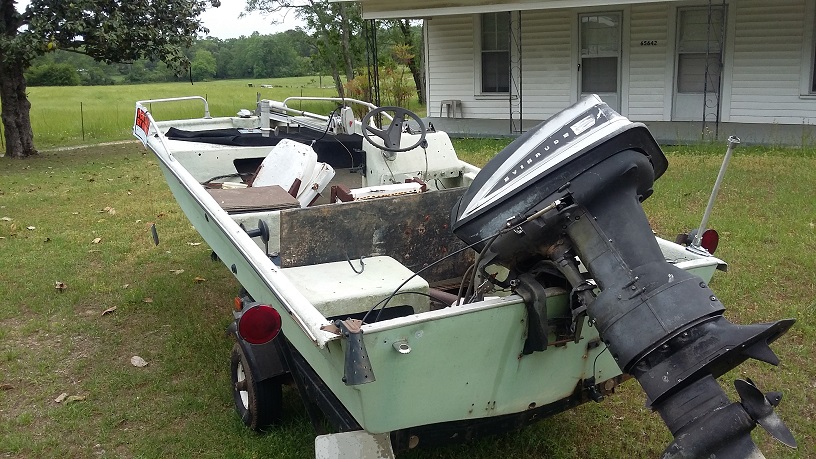

      Hopefully this is not too far off topic. I recently bought a "Lucraft" 14′ boat. It has a 40 HP Evinrude Lark IV. I want to replace the engine as it seems to be a lot of engine for a 14 footer. Unfortunately the boat data plate is missing, so I do not know weight capacity or motor HP capacity. Having trouble finding info on the lucraft.
      Anybody out there have access to a Lucraft 14 foot dataplate? Maybe you could send a photo of the plate? (Naturally with serial number obscured.)

              #62151
              lindy46
                That looks to be a mid-70’s 14′ tri-hull utility – motor capacity of 35hp. Also looks to be a short transom. Measure to see if it’s about 15". Your 40hp is a long shaft. Does cavitation plate ride about 5" below the bottom of the boat? If so, you probably need a short shaft motor. I’d look for a mid-70’s 25hp or 35hp motor.
