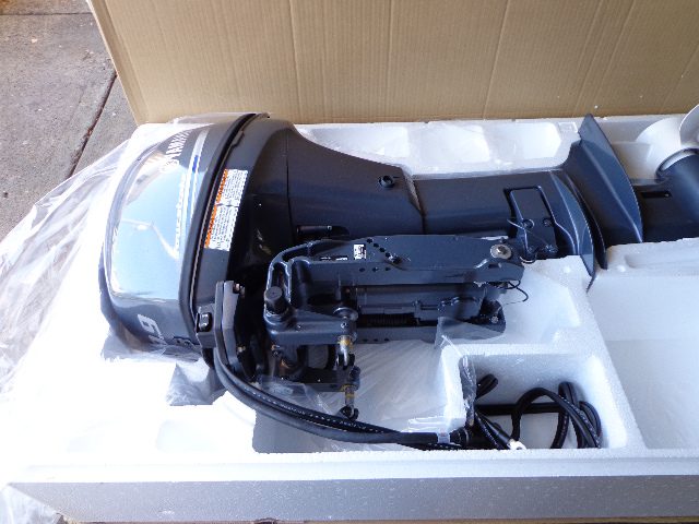

                    I think all older motors were test run at the factory and again by the dealer for final adjustments before handing them over to the customer. At least the ones my father bought new years ago were run in the dealers test tank before he took them home.
                    Can’t say the same for newer Yams I’ve bought which came in a sealed box.
