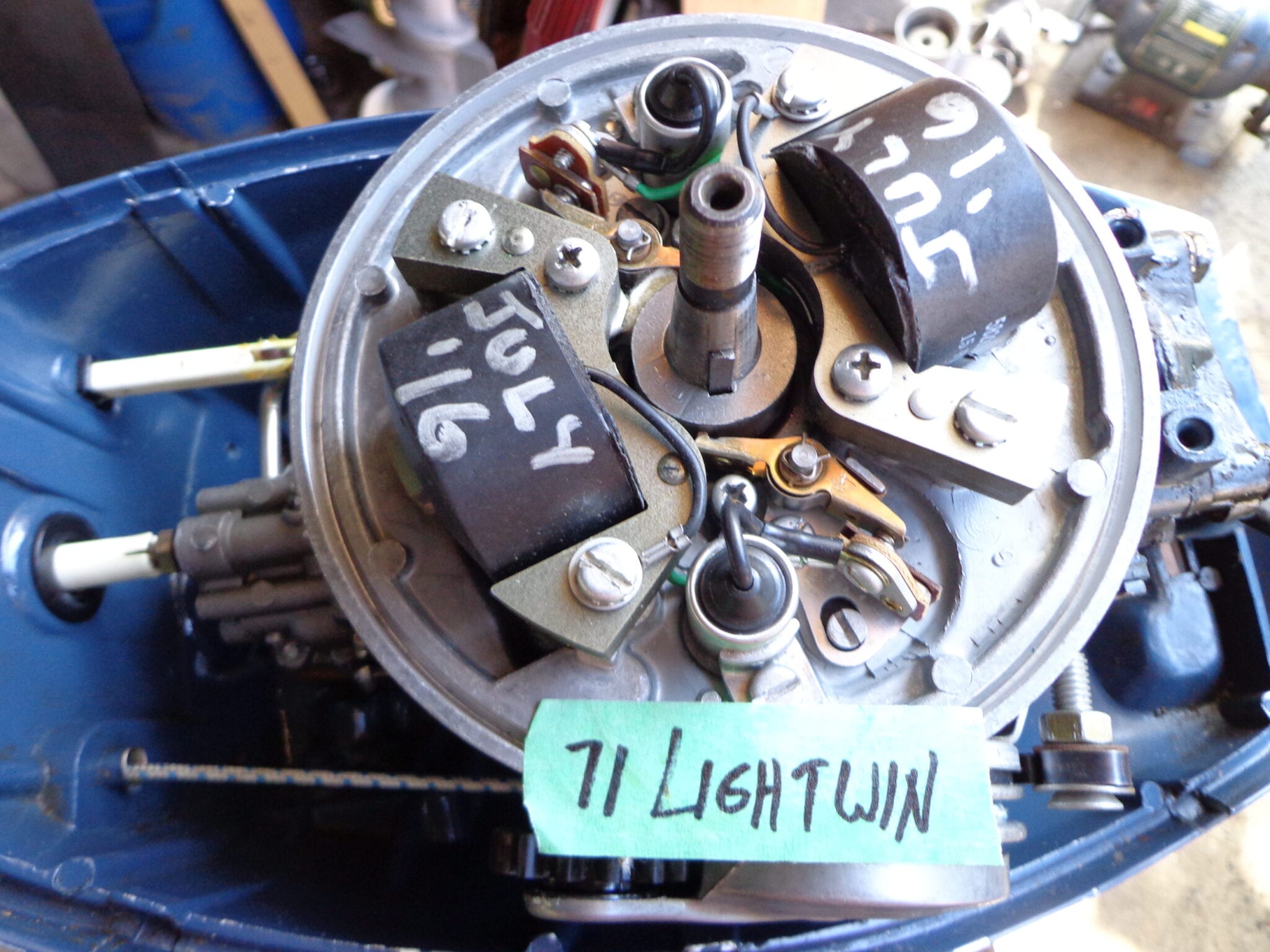

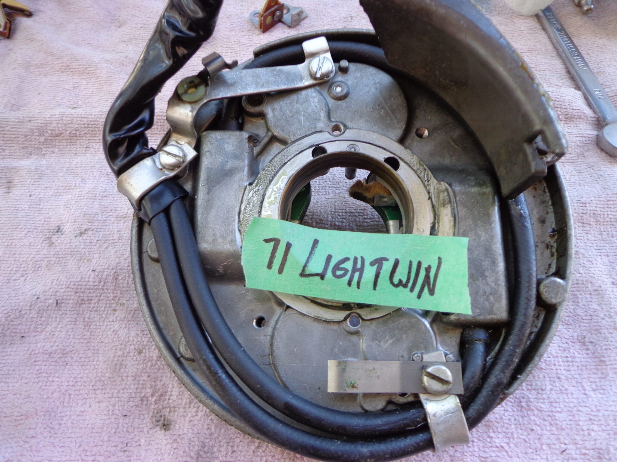

                        Here’s the same mag as on your motor. Pretty basic on top and the only place the plug wire could be worn thru is where the two hold down clamps are on the bottom. The other little strip of metal at the bottom is for grounding.
                        DSC00017
                        DSC00016
