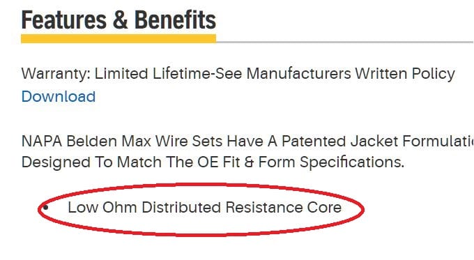

      If the new wires are solid core, I’m wondering why they advertise them as ‘resistor’???
      Wires
      #230449
        exactly….low being 0 ohms on my meter but has indicated they also use the same language for BMS 700715 (marine application wires) vs mine which are BMX700175
        in ay event I have used these BMX700175’s before and no issues cames up and…. it works fine on my bottom cyl.
