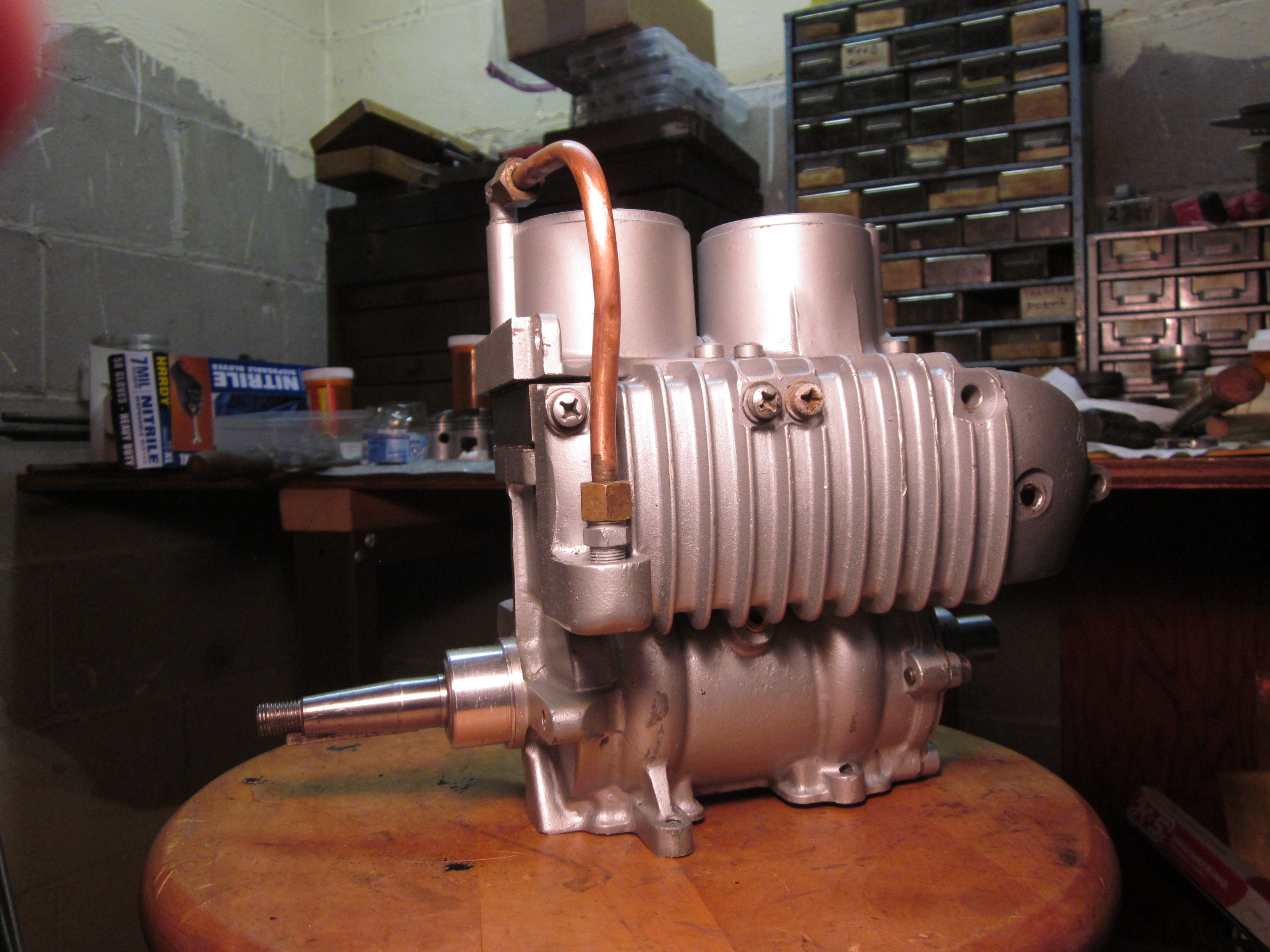

    dockbuster1
      Part one a bit more than halfway through
      #57010
      chinewalker
        Part 2, 9:10 in….

              green-thumbs
                The sticky point is the missing intake/reed assembly. Finding that unique part for a one year limited production semi prototype model strikes me as a toughie. If anyone has an extra
                intake /reed assembly I would like to hear from them.
                Louis

                green-thumbs
                  Update on recreating Mercury K4…powerhead is assembled, leg is being put together, in a day
                  or so parts will be joined. Getting K4 this far depended upon a lot of help from a lot of friends.
                  Thank You one and all.
                  A more complete story later.
                  Louis Doering
                  #69559
                  green-thumbs
                    The story of the unknown crankcase assembly is now known. A few newly found remnants have shown up, including the rope plate marked Mercury K4 serial # 1150 and the Eisemann fly wheel magneto assembly which has a small diameter mounting hole. I was concerned that the crankcase extension might have been machined undersize at some point as the magneto plates on hand had large diameter mounting holes and did not fit the crankcase snugly. All in all the bare crankcase assembly has led to a very interesting project, although, not without some learning experiences. Not a complete ready to show and go motor as a few more hours of detail
                    work remain.
                    I know of 6 examples of Mercury K4. I wonder if there are others in club with them and I am also curious as to Mercury K5 model and Wizard WA6 versions. At some point I will write up a long story with all the twists and turns complete with photos and credit due to those who contributed to project. I owe them one and all.
                    Louis
