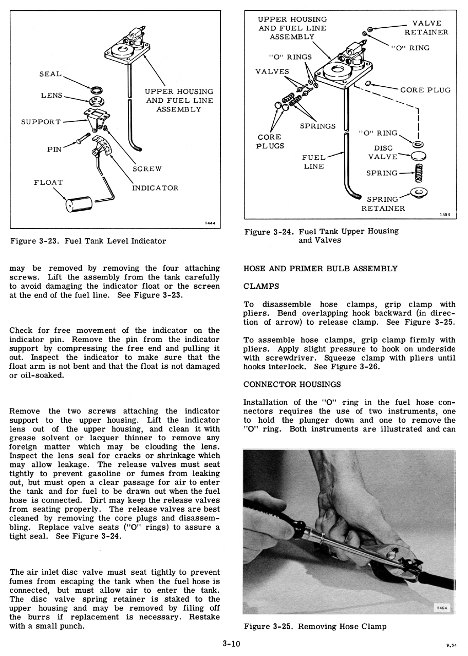

      quote Garry in Tampa:
      Here is the parts book . . . πŸ˜€
      Gary – part #16 (valve retainer) is captured by deformation of the edge of the hole in the housing it sits in. It appears to be the only way to replace part #17 (O-ring).
      Do most people just give that one a pass?
      Or am I looking at some dremel work?
      And why are the core plugs so damned expensive?
      ETA: any hints/tips/tricks on removing and installing part #36?

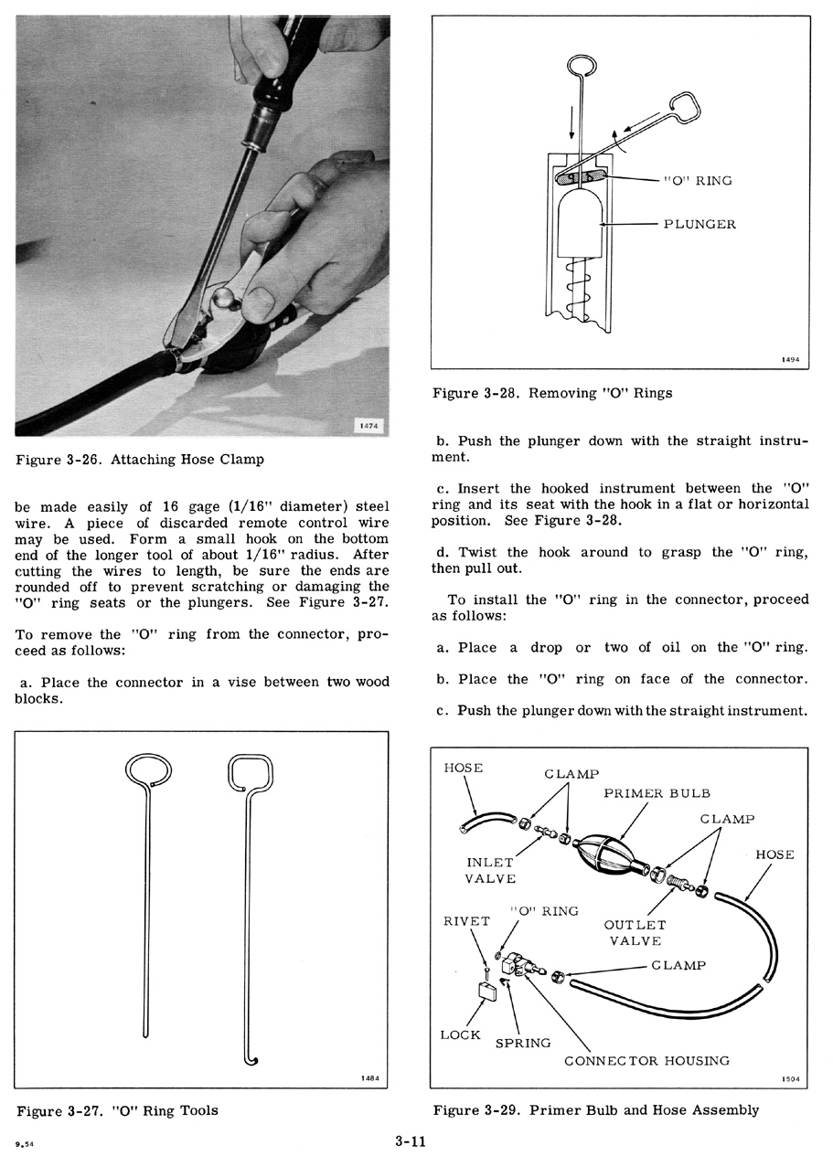

      #63239

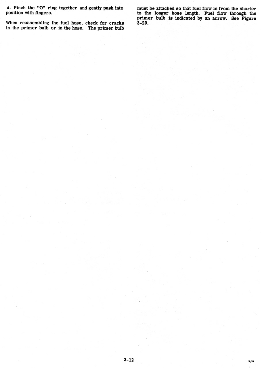

        About that connector seal "O" ring, Pick out what you need . . . πŸ˜‰
        #63240

            Thanks Gary – that’s just what I was looking for!

                  #64148
                    That tiny little o-ring around the pin is a very troublesome item. When they leak, the fuel pump sucks air from around the pin. There are two sizes of the o-ring, early ones being smaller than later ones. The early ones are especially prone to leaking. It is removed by removing the core plug, then sliding the pin & spring out. Then stick a punch or something in the retainer #16 and rock it out. Use a hammer and screwdriver to stake it back in.
