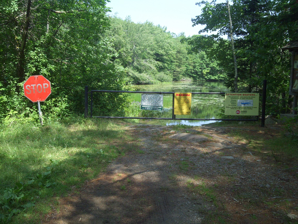

July 4, 2017 at 1:38 pm #60957While several lakes already ban the use of the motors
we collect more lakes are being added to the list
all the time. All of those that promote the use of these
excessive amount of oil contribute to the cause of these
regulations to be enacted. These people see our motors
as air and water polluters. All my life I have seen
places for hunting, fishing, dirt bikes, closed by
people who could care less about offending the people
who have the control over these areas. Offend the wrong
people one time and local governments as well as home
owner associations can lock the gate. Of course you can
run all the oil you want in a barrel.A "Boathouse Repair" is one thats done without having tools or the skills to do it properly.

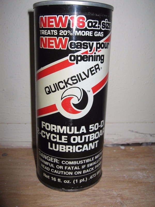

July 4, 2017 at 5:15 pm #60970As early as the 70’S manufactures were trying to get
customers away from using 4 cycle crankcase oil.
The development of TC-W was to produce a lubricant
to me mixed with gasoline and extend engine life.
As a result of the development of even better additives
(friction modifiers and detergents) today we have
TC-W III.
Formula 50-D has long been replaced.
More and even better products are available today
for cleaner burning and longer life while at greatly
reduced amounts. These products werenât available
when these decades old manuals were written.
You donât only drive cars the year you were born.
You donât only use phones made the year you were born.
You wouldnât take grandma to the doctor, hand him
a medical journal and tell him to only use the treatments
and procedures from the year she was born. Putting
excessive amounts of oil into our air and water when
it isnât necessary can have lasting effects on this hobby
that you’ll never be able to reverse.A "Boathouse Repair" is one thats done without having tools or the skills to do it properly.
