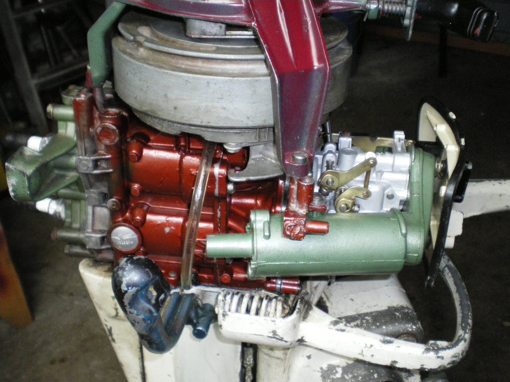

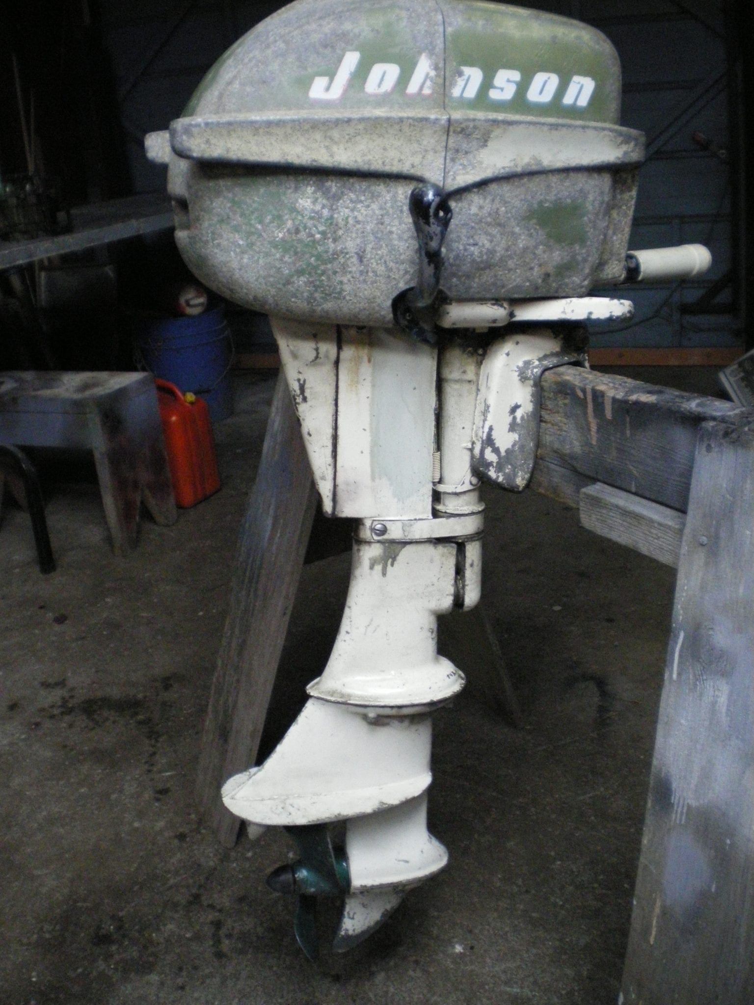

          Actually I am trying to make one good power head out of three junkers.
          Don’t give up. It can be done!
          Here’s my 54-55-56-57-58-59 Johnny Rudeaneer assembled from spare parts and it runs great! She may not be very pretty but she’s sure loveable!

            Wow Mumbles..Can’t believe you would not have that motor painted up perfect and pretty like your others.
            Then again it’s kinda relaxing to just have a good runner that you are not constantly concerned about getting a scratch on it.

                LOL!! Yes I have one of those Johnny Cash specials! It looks very much like yours, even the hood! I tried to sell some parts but got no takers. Came down to fix it or junk it. I was worried my 56 power head was not going to work on my 55 leg. Looks like it works for you. Very funny indeed! Sorry for hijacking your thread.
                  Yes, you are right, they don’t work normally but on this one I filled in an area on the bottom of the block with Marine Tex epoxy so it would work. Otherwise, there would be a massive water leak going on in there.
                  The exhaust housing on this motor is from a ’58 Viking which is the same as the ’54 and ’55 Johnnyrude housings and the block is from a ’58 Johnson CD. Here’s a video of it actually running in the test barrel.

                    Mumbles- great example of “nothing’s impossible”. That’s more like a Franken-freak than a Frankenstein but it runs great so who cares! Great job!
