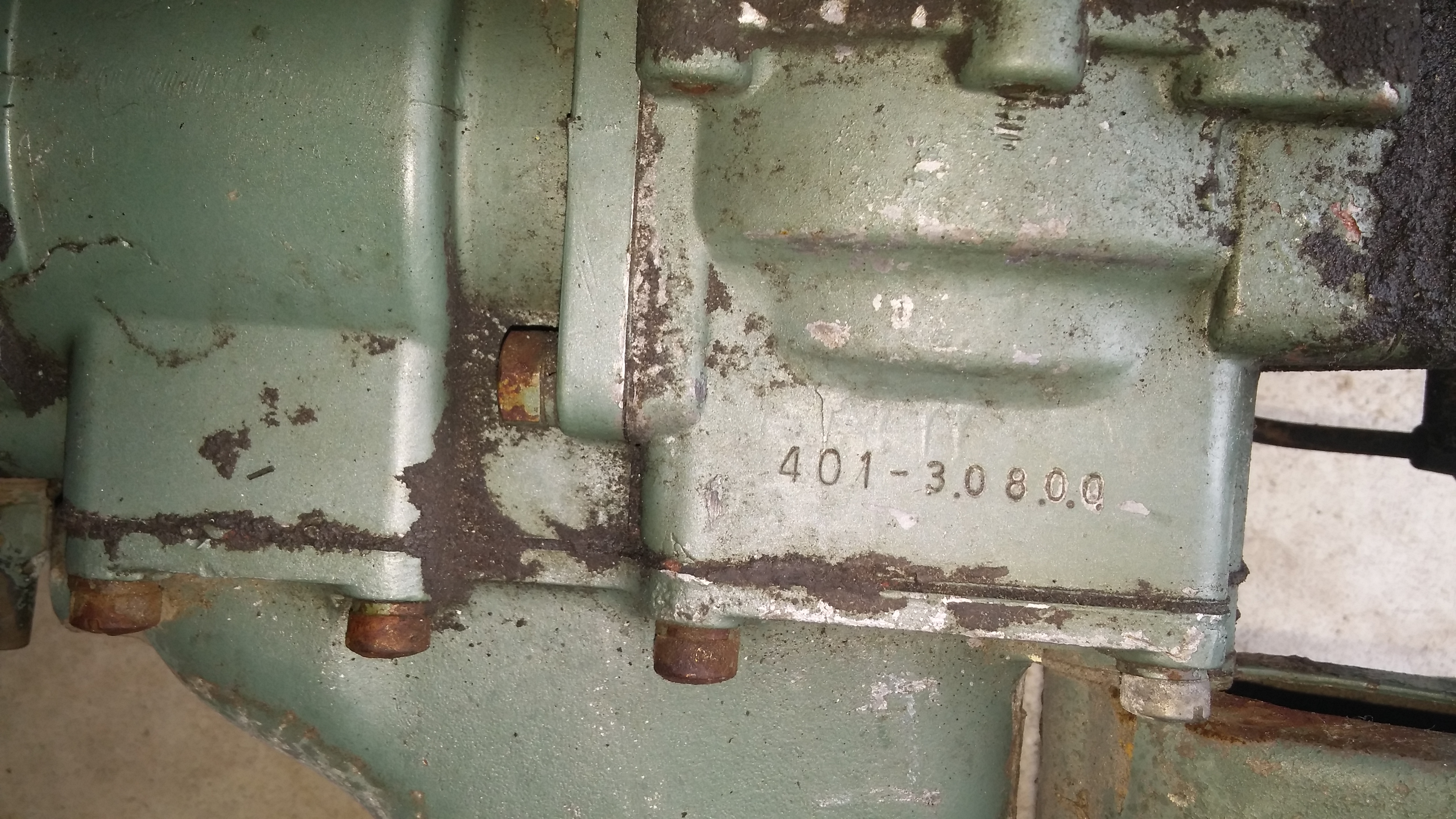

      Just got another tick but this one is a real hurtin unit. I am pretty sure it is a Sears Elgin but the model/serial number is 401-30800. Th decals are very faint to non exsistant but it appears to be an Elgin. My question is why the number 401-30800 should it not be a 500 series number or is it because I am in Canada and this is more than likely a Canadian model? Pictures to follow of for my anniversary dinner right now… 39 years and counting. If I keep buying motors I may not see 40 LOL. Actually this one is a freebee.
      #57660
        Yeah, Sears/Elgin did that on some models just to drive us crazy. They had a "model" number that did not match the real model number, which would be a 571.xxxxx (made by West Bend)

        punchbug
          here are the pics…like I said she is a hurtin unit

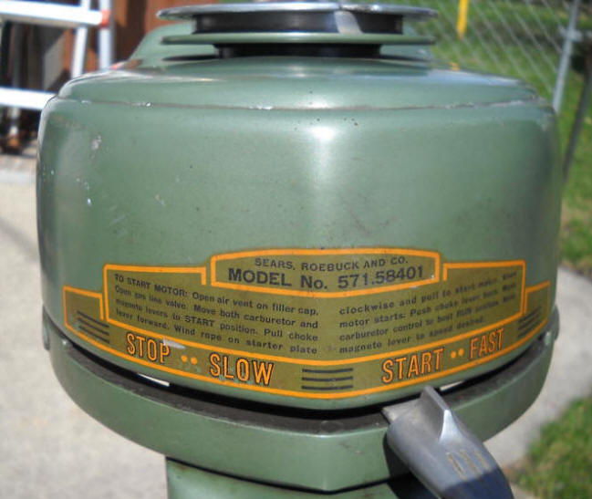

              #57692
                The 401 stamped on the motor is part of the model number, 571 (Sears) -58401 and the next number is the serial number. The complete model number would have been on the tanks front decal.

                  #57701
                    Mumbles, appreciate the manual, just what I was looking for. Your motor looks to be in great shape.

                    punchbug
                      Thank you everyone….. The front decal is faded almost completely so no chance of see any numbers
