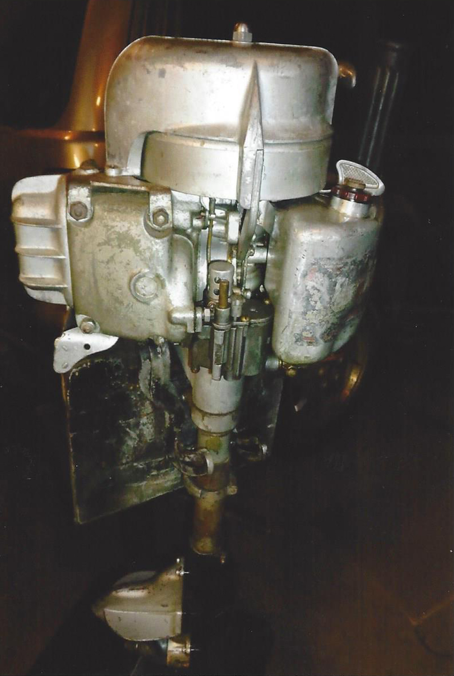

      I have had an AT 10 as the one above – also a DT38 as above also. The motor I refer to is a 4.2hp block otherwise like the AT10 above. A special fitting has been made -doesn’t look homemade for the front two bolts on the recoil, holding it to the block. I am still struggling with photos. Have 4 great photos and no idea how to get them in here.

              ERROL STILLINGS
                Thanks Garry, Tubs, and Phil B. Garry, I see you got one of the photos rotated. Wondering how you did it?
                I installed the photos three times. After seeing the photos upside down, went back and rotated the photos in document storage and installed a second time. And, they were upside down. So, went back and rotated the photos back again, reinstalled and still upside down. After reading Phil B site, perhaps I should have reinstalled in my document storage. In any event, I will practice under PREVIEW before SUBMIT. In the meantime, wondering
                what motor this is. Now there is one photo showing it, right side up, thanks to Garry.

                kees
                  International Member
                  still wondering what motor it is ? 🙄
                  your block is from an LT-37 or LT-38
                  Model LT-39 and LT-10 has a different block and with the recoil starter they call it an AT-39 or AT-10
                  so I think ❓ …. they put a recoil starter on the LT-37 or LT-38
                  just because it fits
                  you are the judge
                  other options ???? by others
                  btw. your welcome 😳
                  #59691
                  ERROL STILLINGS
                    Kees, I think you are right. LT39 & LT10, AT39 and AT 10 are 5 hp with the same 5 hp block used for many years. The 4.2HP block was used in the LT37 and LT38, DT37 and DT38 and discontinued. The 4.2 block has no usual cylinder head but what I would call a cast block. The fitting for connecting the front of the recoil to the block looks like a factory job. I’m going with an LT37-38 with an added recoil, which is the same recoil used on the AT10 but not bolted on the front of the block as is the AT10.

                      ERROL STILLINGS
                        Thanks Garry. You are way ahead of me with technology. I’ll record and try to remember for next time. In the meantime, I am going to consider
                        this motor an LT37-38 with a recoil attached. Thanks for the efforts of all who responded and put up with my inemptitude on placing photos.
