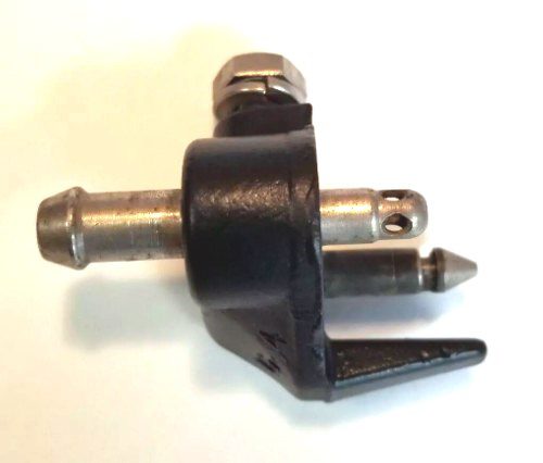

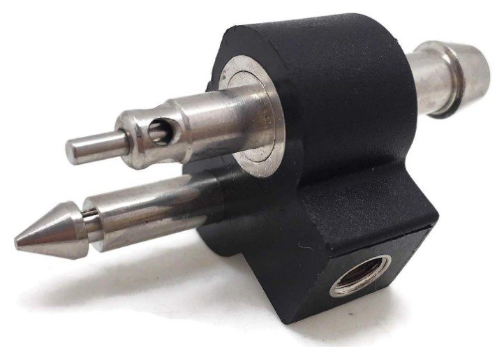

          I don’t know if you can unscrew that pick up assembly and screw in one that has a male connector. I’m not sure I’ve seen one of those on the 3 gal. So you have to attach a short length of hose to the tank and attach a male connector to the other end. Then your female on the squeeze bulb assembly will be able to quick disconnect.

            That second picture you posted helps. I didnt realize they had one available with a valve that would seal when the fuel line was remove. Thanks
