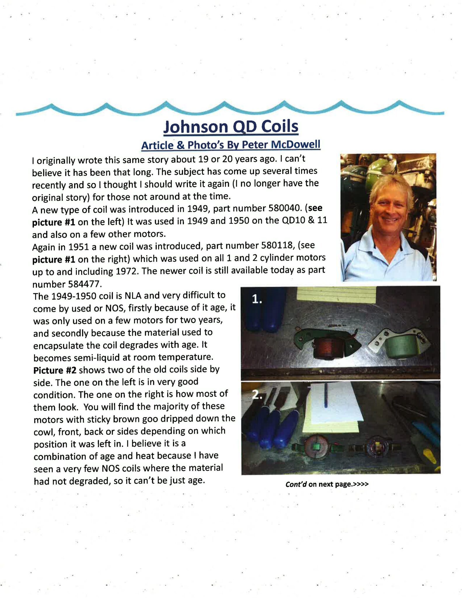

Happy Labor Day weekend everyone! Thinking of purchasing an older qd Don’t believe it has the universal ignition. In fact, it looks like the coils have melted and run down the powerhead can replacements be found or what are my options if I want to purchase this motor and get it running. Thanks!

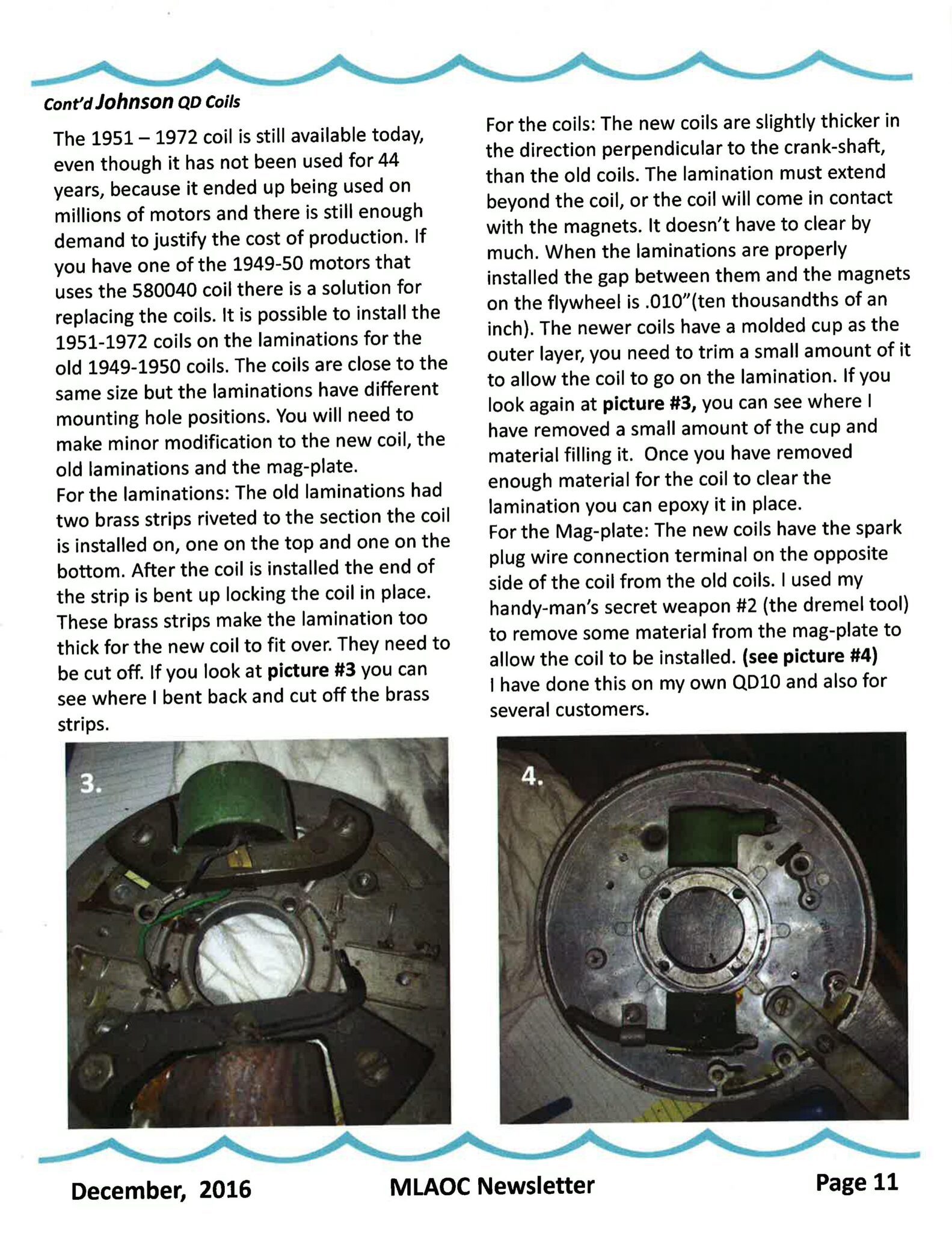

September 2, 2023 at 9:18 am #280065I had a QD-10 once, and it seemed the coil design was inbetween
evolutions of the early “inward facing” coils, with the center rotating magnet,
and the OMC Universal coils.
Sadly, I can find no photos, but I was able to use Universal coils to get it going
again.Prepare to be boarded!
September 2, 2023 at 10:31 am #280066If you do a Google search for QD 10 coils AOMCI or similar search words you’ll see a few articles on retro-fitting the universal style coil to those earlier laminates.

September 3, 2023 at 12:38 pm #280121The BRP catalog that links to Marine Engine lists the same coils for 1949-1963 10 HPs. Look it up at this link by scrolling down to 10 HP on the chart, then click on the part number: https://www.marineengine.com/parts/brp/johnson-evinrude-outboard/ignition-coil.html
