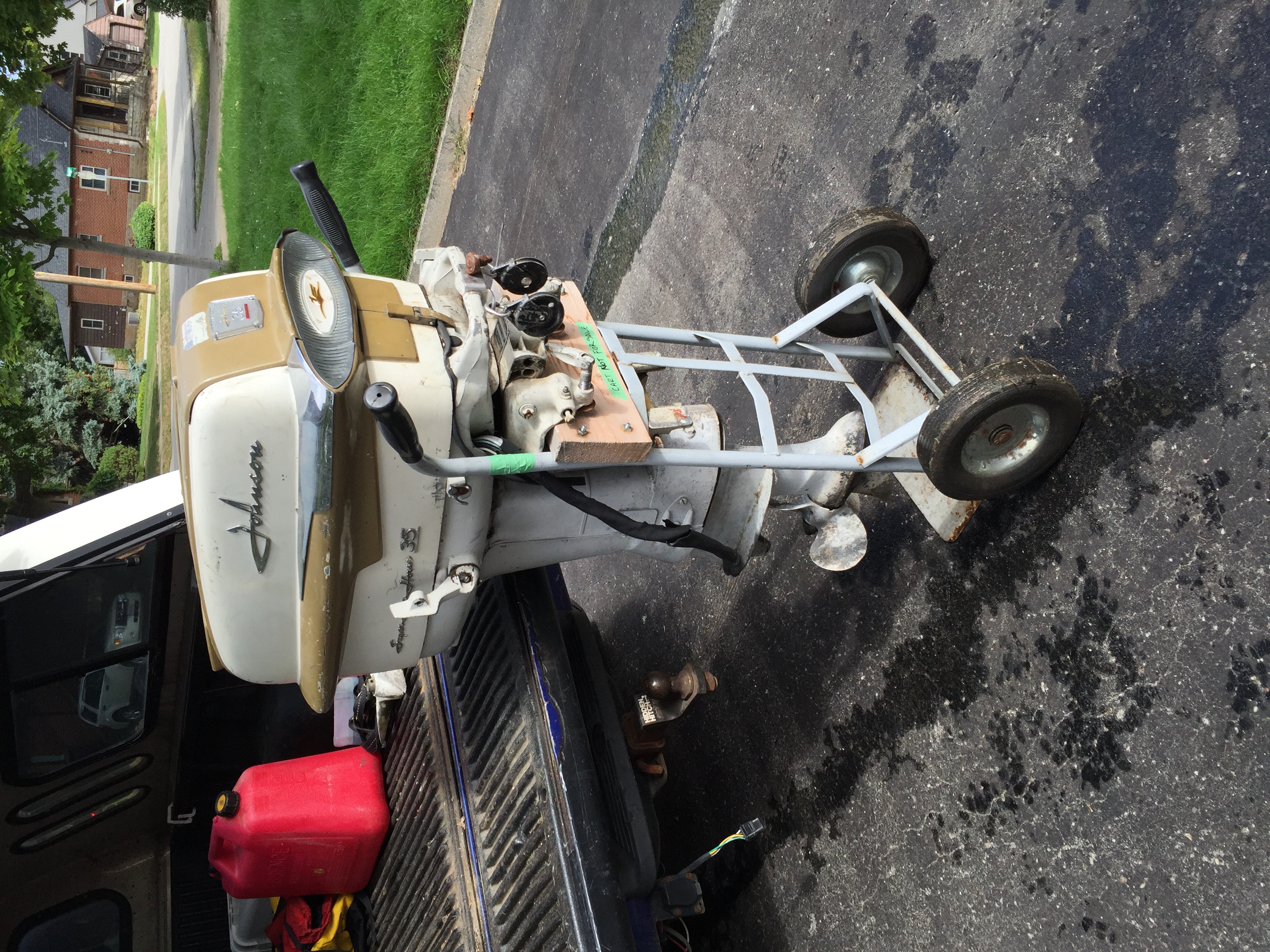

                      I thought I’d give an update on the project. I have found and purchased several 1958-63 OMC 35-40 hp motors locally. Too many really. Good thing they are cheap. I am building two longshaft 1961 40 hp Johnsons for use as twins on my cabin cruiser. I am dressing them to look like 1958 Johnson Super Seahorse’s. Fortunately, the Super Seahorse cowl fits the newer 40 hp motors without modification. I am still looking for another 1958 cowl if anyone has one.

                        Also, I’ll be replacing the 40 hp hot water choke carbs with the 35 hp adjustable jet carbs since they appear to be the same size. I would rather have fixed jets, but I have no interest in the automatic chokes and the motors will be mounted on a bracket that stands off the transom so I won’t be able to easily reach them from the rear deck If the auto-chokes fail.
