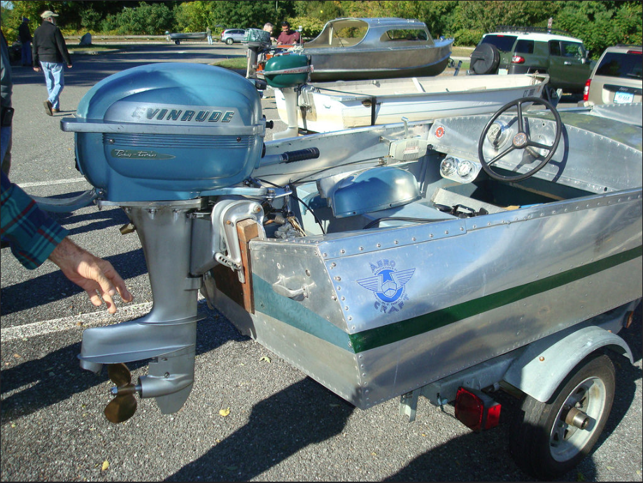

              dmbono
                that’s a nice looking boat- what is it?
