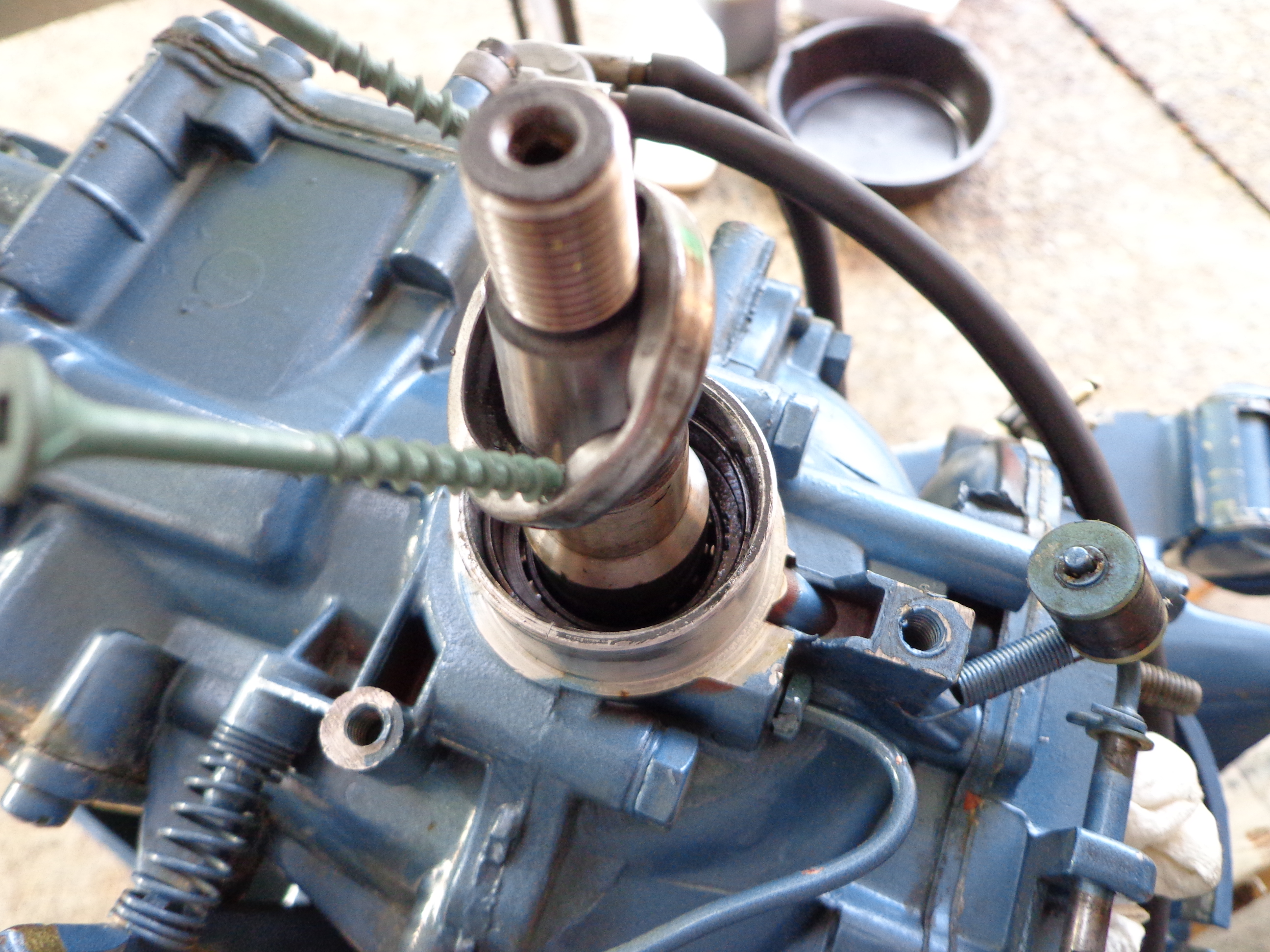

      If you don’t have the proper puller or a lathe to cut the old seal out, some well placed deck screws will work.
