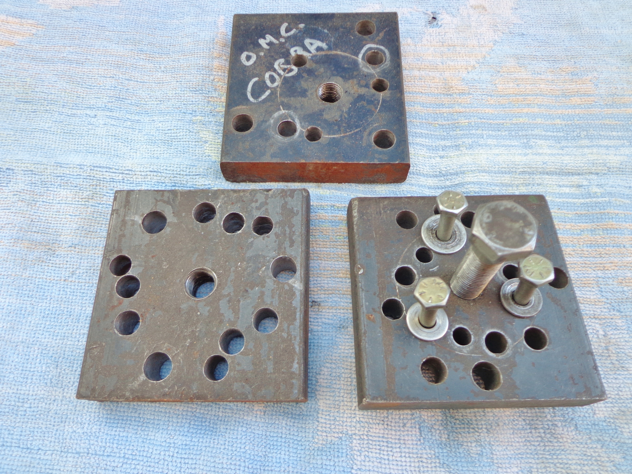

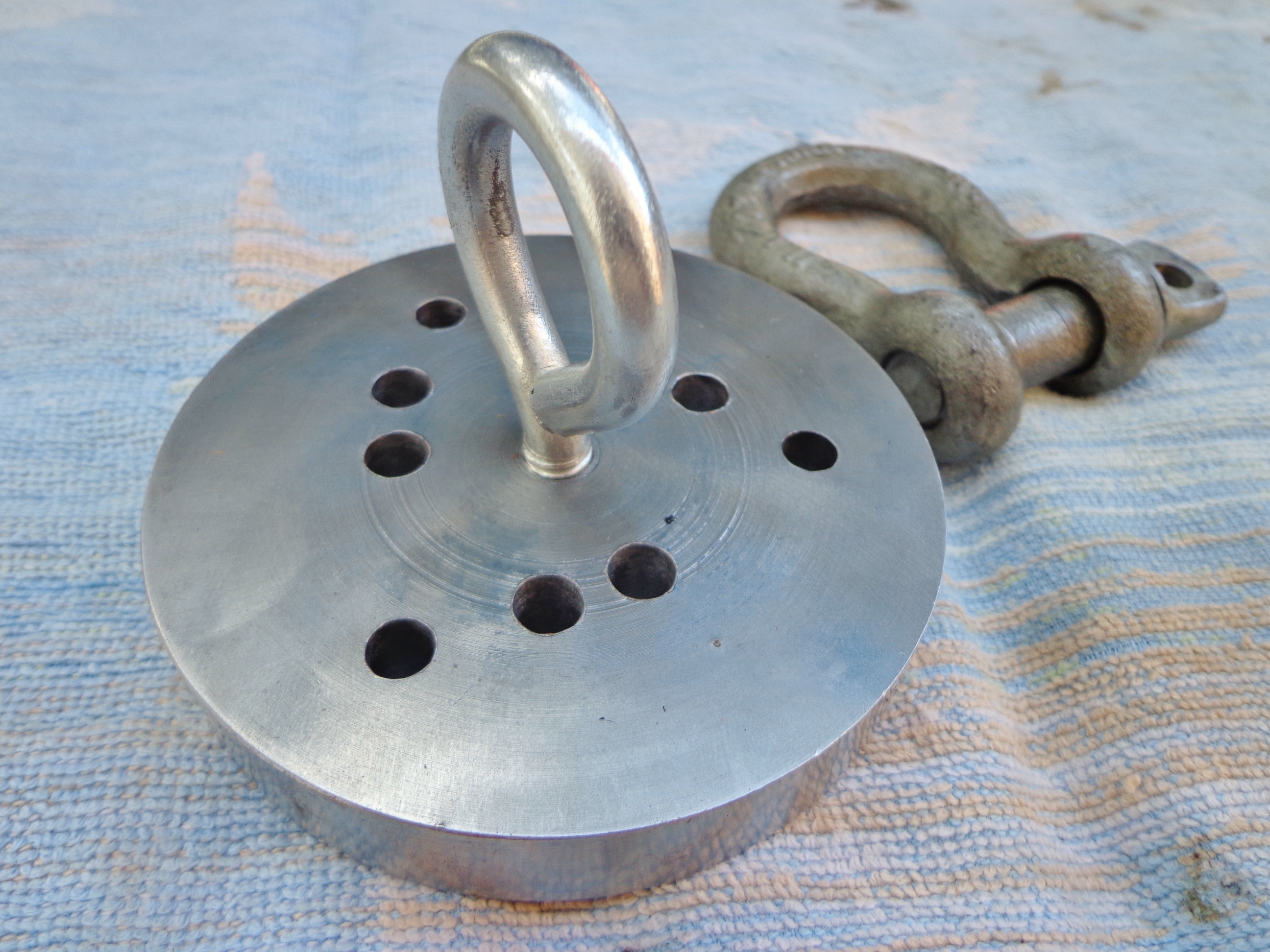

          No expensive and fancy store bought tools for pulling flywheels around here. Scrap iron serves the purpose and the round one doubles as a lifting eye for heavier motors. 😎

            When i first started working on outboards ,i had a friend make me a puller like the one Mumbles showed to remove the flywheel off my 25 hp.
            I do like the idea of the BRP puller not having the conical point on the center bolt that could enlarge the diameter of the crank threads.

              mumbles, how much weight do you put on that hardware-store eye-bolt?

                First thing I thought FrankR! Course I am use to lifting V-6 Loopers & an occasional V-8. The lifting eye that screws into the factory puller is 3/4" X 16 TPI I think.
                Nothing wrong with the rest of the plates! The key is the shoulder bolts & thick hardened washers.

                  Here is some light reading….:
                  http://www.almabolt.com/pages/catalog/b … ensile.htm
                  I read that as a 1/4 -20 bolt, grade 2 can hold a proof load of 1750 lbs with a tensile strength of 2350 lbs.
                  That is not the same as the amount of twisting torque they can handle..
                  So how much weight can a 3/8-16 standard bolt hold while lifting?
                  #73864
                    So a 1/4-20 bolt could, in theory, pick up a V8 outboard. However, in the reality of a rough and tumble boat yard, it would only take one jounce of the fork lift or a little angle change of pull, to skew the results……and somebody gets hurt.
                    #73866
                      Just sayin’ this in the interest of safety. Those bent eye bolts generally are not approved for lifting…period. There is a difference in the tensile strength of an ordinary bolt and the strength of a bent eye bolt. With the eye bolt, you are exerting a bending force (trying to straighten it out). Furthermore, it was already bent sharply where the shank meets the eye, and now you are trying to bend it in the opposite direction. We all know what happens when you bend a wire back and forth.
                      Again, just sayin’.
                      #73869
                        Agreed Frank which is why they use such large bolts.. to ensure that the bolt won’t fail… This is one time to err on the side of caution is a good thing
