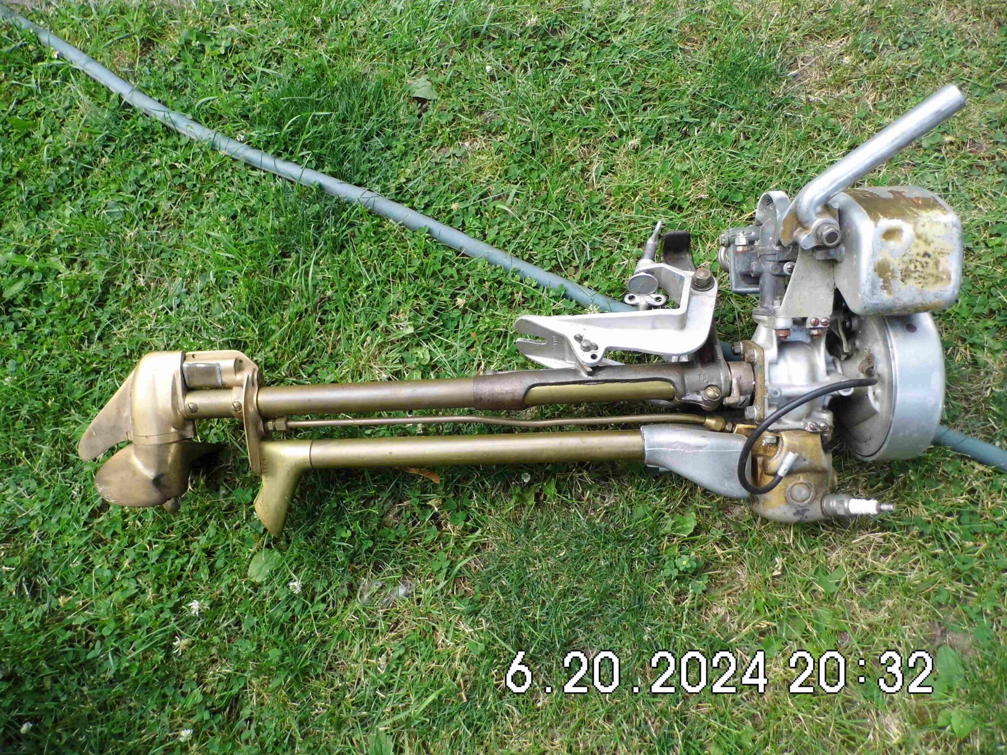

That motor was produced for several years as an Evinrude and as Sea King. Does it have a tag like this? I need the number to correctly ID your motor. Tubs
p
June 26, 2024 at 7:11 am #288646what part of the serial number is the model number?thanks
June 26, 2024 at 7:17 am #288647yes that looks like the tag on it and the first 3 numbers are 432 also someone told me it was an elto ace but it don’t look like the ones that are pictured. I checked the chart if I’m reading it right it is a 1933 2.2hp.
June 26, 2024 at 8:03 am #288648
Your motor is a 1933 Sport Single, 2.2 hp. Model #- 432, the last 4 numbers being the sequence of production. Tubs

June 26, 2024 at 10:33 am #288651does the shafts being made of brass mean it was made for salt water?
June 26, 2024 at 12:58 pm #288652
For the most part, motors from this time, with brass lower units, are considered salt water motors. Your motor looks to be in unusually nice original condition and many here would feel preserving the original decals would give it more historical value than replace them, if they are even available. Tubs
